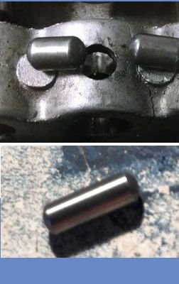

Is this the part you are talking about?

Yes that is what I refer to as the stub shaft. I'm thinking the machined slot is worn for one, making the lever sloppy when connected. I found a shift lever/stub shaft at a local pull yard, I may just take the whole top plate and bring it on home.. the lever/stub seem to be tight, like factory new tight. I've thought maybe the stub could be the issue, as in it's worn down enough that even with new bushings and the side pins it still has play in it and moves the slider incorrectly enough to cause problems for me. Hell I may sweet talk my wife and take the whole trans.. get aquatinted with rebuilding it.

Hey 5.0,
I got the same thing left in my rebuild. I don't see it anywhere on the tranny schematics, I've not touched the shifter parts. I'm baffled. I'm done building, and that same pin was on my speedo magnet. Did you find out where it went?
Old Jul 4, 2020 | 07:00 PM
  #40
Pat Hamer's Avatar
Pat Hamer
Joined: Jul 2020
Posts: 4
I found the same pin. Damn!!!!
Originally Posted by 5.0 guy
Little update, I took the cover back off and was playing around with the shift action. This little pin just fell out onto the bench. It isn't hollow. Any idea where it come from?
So, did you ever find out where that pin went?
So, did you ever find out where that pin went? It looks like it was from my Transfer case 1534. I remember that, I think. I think that it came with a new part, and it floated around with my nuts and bolts. Not sure yet, I'm waiting for confirmation. The 1534 ford part number is 7B362B https://parts.ford.com/shop/en/us/ha.../pin-6533383-1

How would it get from the transfer case to the transmission?
And then not take any of them out?
To me that looks like the pin for the shifter stud in the picture above.
It would go thru the shifter tower and the stud pivots on when shifting.
I know on a T19 you have to be vary careful they don't fall down inside the transmission or you are pulling it apart to get it out.
If it was to try and go thru any of the gears kiss the transmission good by.
Did you have all the rollers for the bearings in place when you took it apart?
Dave ----
So, 5.0 guy found a pin that didn't seem to fit into the m50d trans after putting it back together. I found the the same exact symmetrical pin that he found. I never said that the pin was found in the transmission. I rebuilt both the transmission but the transfer case first. This was a few months ago, and I got busy. I ordered parts for the transfer case, and there is a pin like the one I found in the 1534 bw transfer case, and I have the part.ford.com part number. so, when I ordered T case parts, that pin was in them. The old pin, I'm hoping, but pretty sure now was in my parts cleaner from months ago. When I found the pin, it was on the magnet of the speed sensor, and so that was the last thing to put in the transmission, and I'm like oh crap. But, I'm trying to get ahold of 5.0 guy to compare notes.
I'm quite sure that the pins you think fit that shifter are different than the one I found. I don't see how they can come out without dismantling the rods. But. I'm confident that the pin is not from the transmission. I'd give a buck or two to find out what 5.0 guy came up with.
Obviously the two top pins from the shifter are visibly not symmetrical to the bottom mystery pin.

Longshot as this is an old thread, but I took the top cover off of my M5OD to inspect the forks, and I found the same small pin in question just laying in there... @5.0 guy and @Pat Hamer do you remember if you ever figure out what this is for?? I'm locked out of 5th and reverse and I'm wondering if this pin plays a role in my issue.
