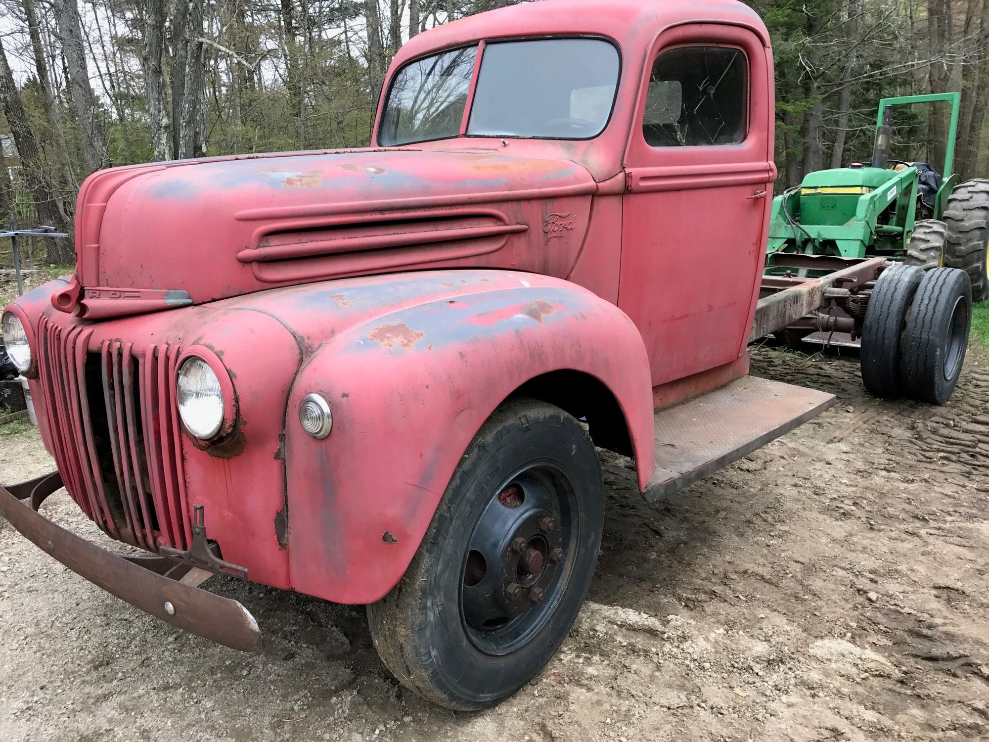

I'm helping my buddy get this old 1.5 ton cab and chassis going but the rear end is locked up and the backing plates are rotted. I've also heard that these rears are geared very very low and top speed is about 40mph. He'd like to be able to go 50-55mph without stressing out the old flathead. What are my options for swapping this rear out? Someone told me a 1970's Dodge motorhome rear will have the same wheel size (19.5") and lug pattern (5X8") but I'm afraid it may be too wide and those Dodges arent too common in the northeast. The current rear end is about 50" from backing plate to backing plate. The rear wheels have been swapped from the original widowmakers and the tires have good life so I'd like to try to keep it in the 5x8" lug pattern if possible. Any suggestions?
