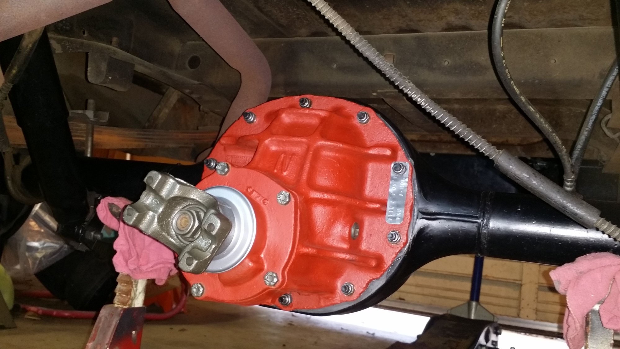

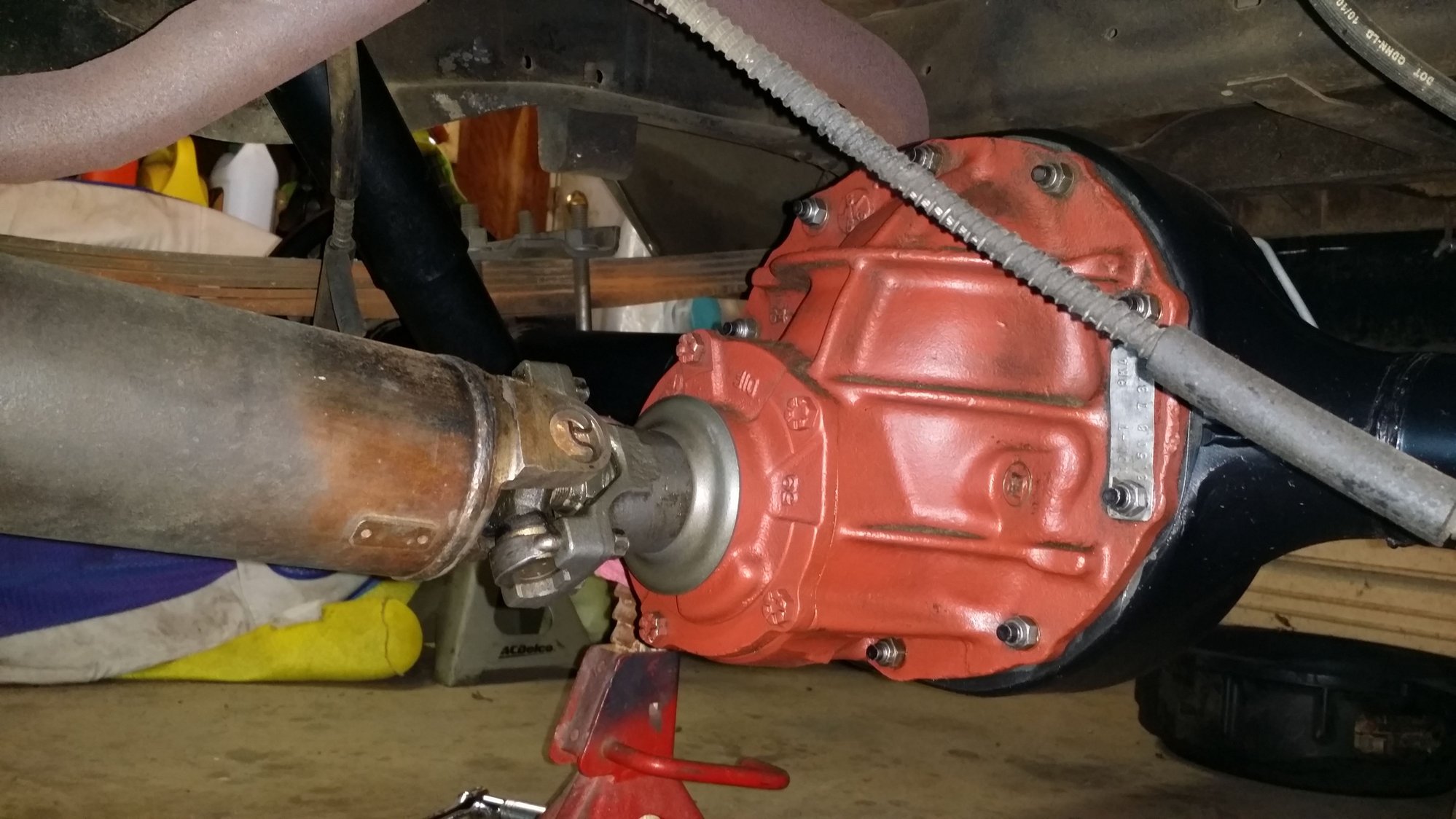

On '67 F100s, yes. On '68-'72 F100s with the Ford 9-3/8" rear end, no. The Ford 9-3/8" rear end is very similar to the Ford 9-inch rear end but is not the same as the 9-inch.
All Bumpside 9-inch rear ends had 28-spline axles. The optional '68-'72 9-3/8" rear end was available with two versions of the 31-spline axle. If the 9-3/8" rear had an open differential, the 31-spline axles were rated for 3300#. If the 9-3/8" rear end had a Traction-Lok differential, the 31-spline axles were rated for 3600#.
Any Ford 9-inch 3rd member will fit any Ford 9-inch rear end (car or truck). The main determining factor is that the spline count of the differential will have to match the spline count of the axles in the housing that the 3rd member is being installed into. The other thing to be mindful of are the companion flanges on the front of the 3rd member (where the trailing end of the driveshaft attaches to the 3rd member) companion flanges on passenger cars tend to be longer than the companion flanges on pickup trucks. The flanges can also be for 1310 or 1330-series U-joints.
9-inch rear ends in passenger cars tend to have high (numerically low) gear ratios. Trucks tend to have lower (numerically high) gear ratios. Traction-Lok was optional in the 9-inch later in the Bumpside production but, you're more likely to find a 9-inch Traction-Lok differential in the '73-'79 Dentside models. Most Dentside 9-inch rears had 31-spline differentials but there were some 28-spline. All '80-'86 Bullnose 9-inch rears had 31-spline differentials.
I removed the 3.50 geared, 28-spline, single track, 3rd member and 28-spline axles from my stock '69 F100 9-inch rear end and replaced them with a pair of 3300# 31-spline axles from a '71 F100 9-3/8" rear end and installed a Ford 9-inch N-case 3rd member with a 4-pinion, 31-spline, Traction-Lok differential with a 3.50:1 ratio from a '75 F150 4x4.
'68-'72 F100 9-inch rears/axles/brakes are different from the '67-earlier F100 9-inch.
