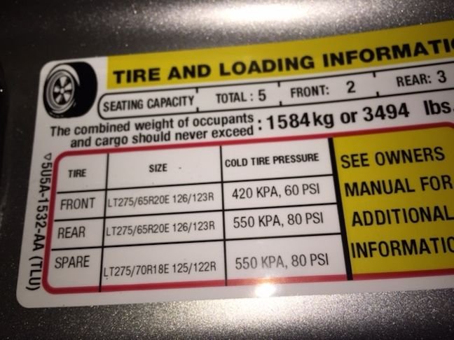

2017 F350 DRW XLT 6.7L SuperCab. Have a 5er at 12,500 dry weight.

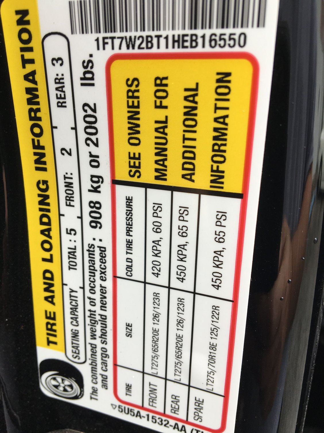

Originally Posted by 2009kr
Inflate your rear tires to 80 and add rear airbags and it should handle the same payload as an F350.
I'm really glad you posted this. My payload is the same at 2000#. The sole reason for getting out of a 2015 Tundra was to sell our tt and get a 5r. Then finding out the pin weight on the Jayco we want is 2200#. Not to mention the 3 of us and assorted camping junk.
After reading you're post I went back and looked and sure enough, all the srw 350's are listed with 80# for the rear wheels. I'm breathing a bit easier now and will feel even better with confirmation that with the proper inflation and airbags if needed will this solve my dilemma?
6.7 CCSB 4X4 LUT
Reach out to Karl4cat (Rodney) for more info. He knows a lot about the paper limits of SRW trucks and how to push past them.
dang it, you beat me by just over 300 pounds
Didn't do it on purpose
Old May 13, 2017 | 09:31 PM
lotsofords's Avatar
lotsofords
Joined: Feb 2017
Posts: 461
Must mostly be the difference between crew cab and super cab. I wouldn't think lariat vs platinum trim would be that much
