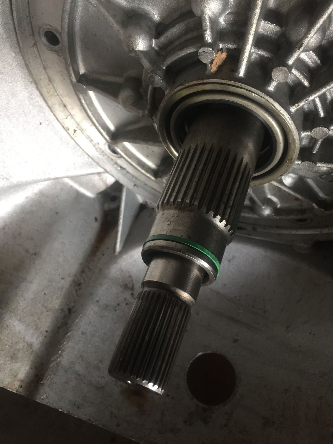

i have a '92 f150 6 cyl with E4od trans and I'm replacing the torque converter and nearby seals.
please help me to identify and properly name this light green split seal on the front of the large shaft coming out of the pump, pic. Below

Front stator support sealing ring, also called Front pump support sealing ring.

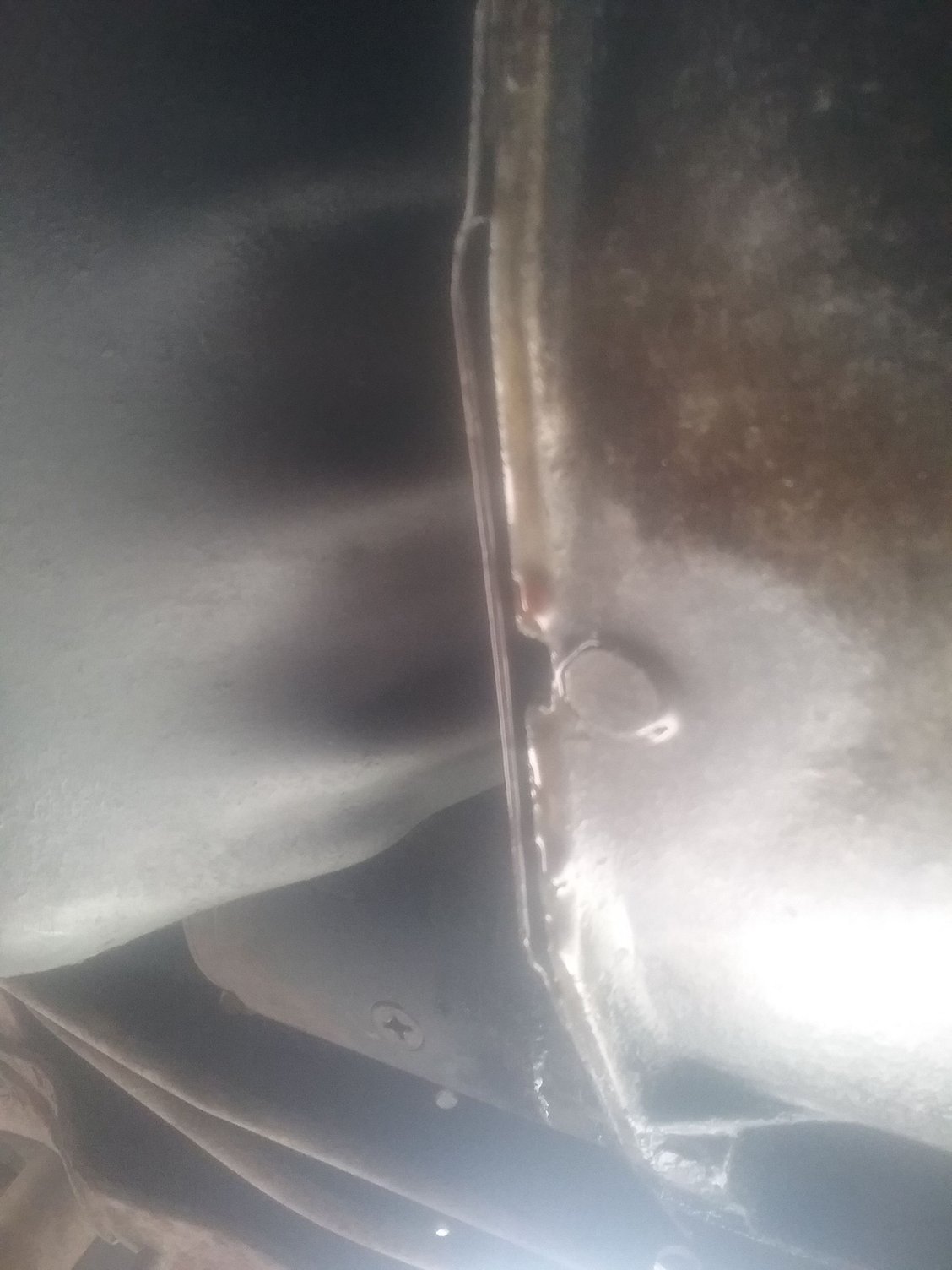

My 1981 ford f250 rwd with a 351w c6 3 speen tranny, it leaks pretty good from this gap can someone help me with this and what i need to repair please and thanks guys

Leaking oil from this gap

Most likely the front pump seal, but could also be the o-ring between front pump and transmission case. Make sure to check the torque converter hub for scoring, or other damage.
