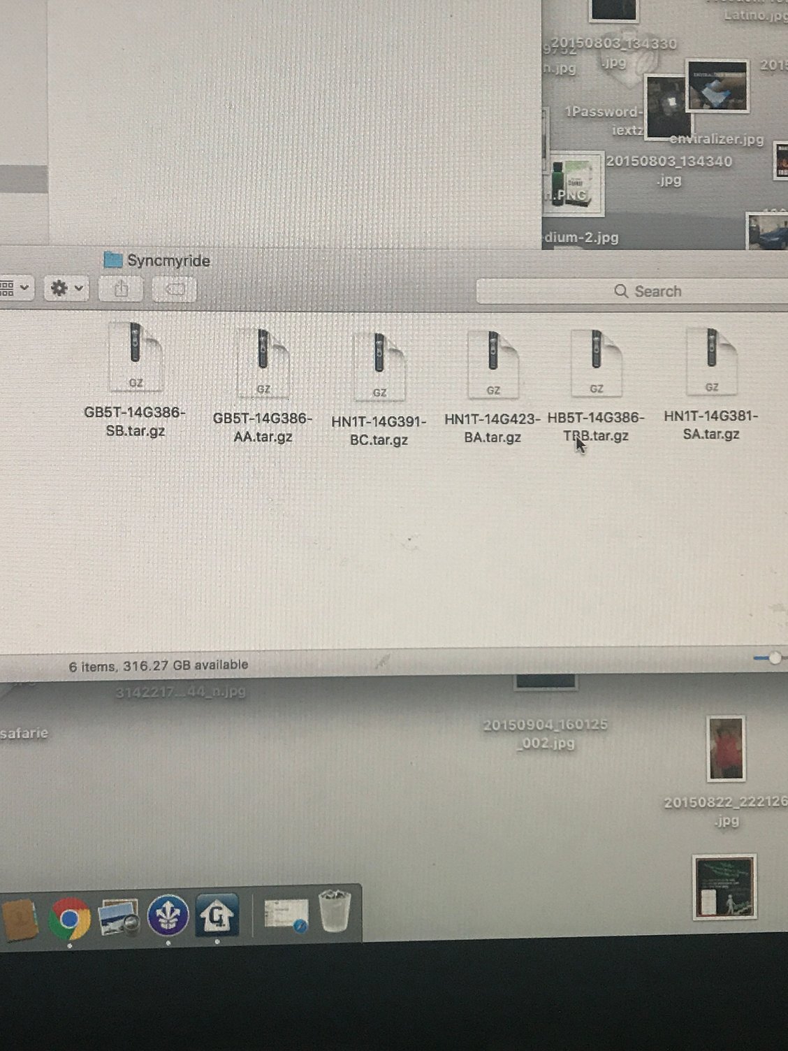

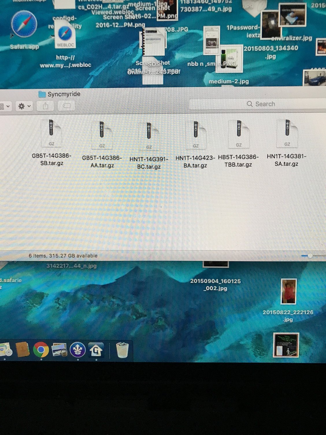

Originally Posted by Fordfan82
What?
Your picture/screen shot started off fine but totally fell apart on the third picture.

Here's how I got it to work :
1. Download the sync 3 update from your ford owner account and unzip the files
2. Create a folder on your mac named syncmyride and drag all the sync my ride files to the created syncmyride folder . Take out the syncmyride part from each of the files. (See attached picture)
3. After the sync my ride files are in that folder drag it to your USB drive .
4. The other 2 files named Dontindx.msa and autoinstall.lst make sure that's also in your USB drive and not in the syncmyride folder. So you should have those 2 files and the folder in your USB drive .
5. Eject the USB drive and plug in. It should be error free.
Make sure you format to exfat prior to downloading the update. Ford told me this was another method for those getting that error message. I was also on 1.0 and went to 2.2. Apple car play works great. Let me know if this works for you.
