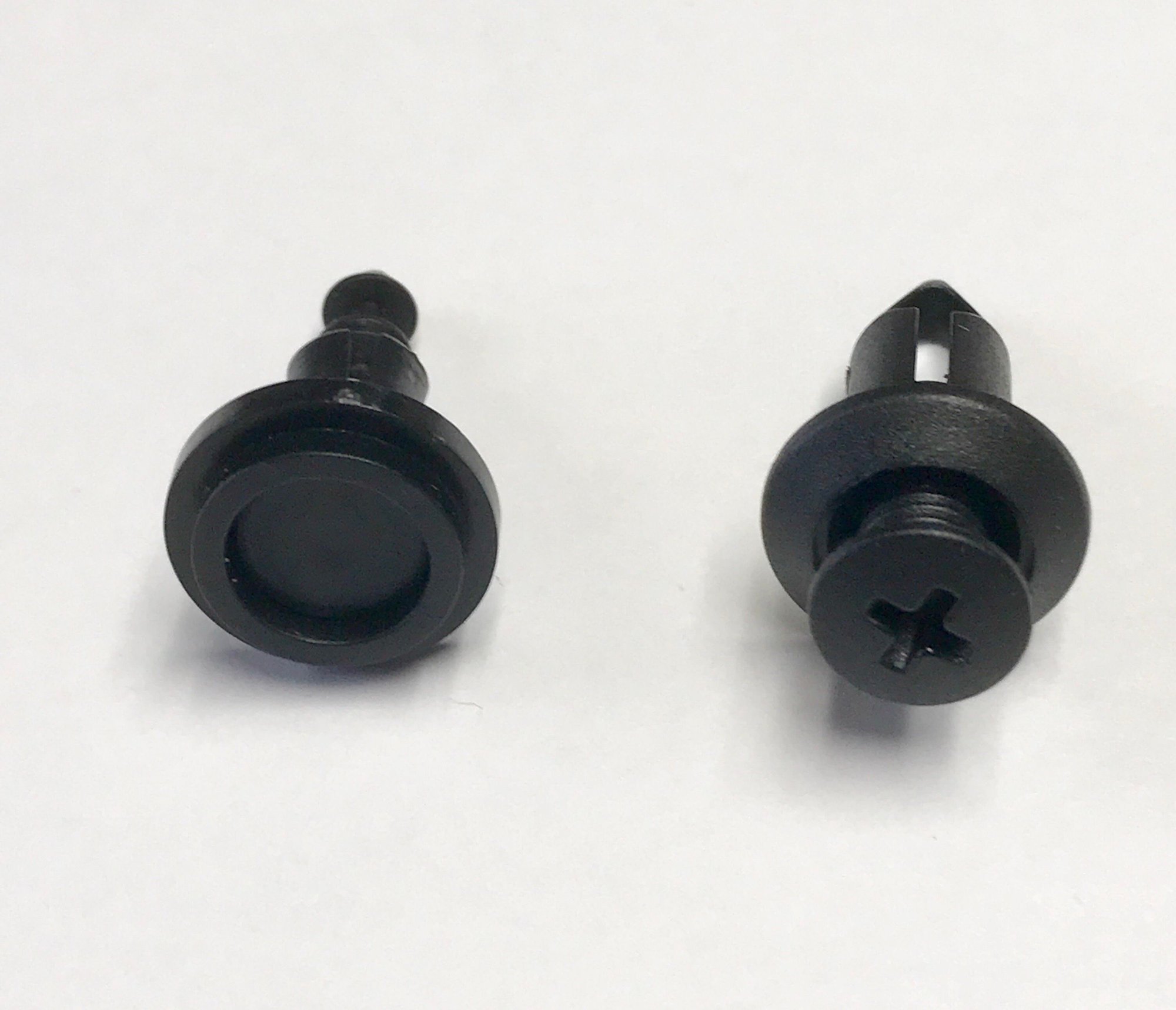

Yes! Had the same problem with mine. I ended up buying a couple different types of Push Fastener Rivets from ACE hardware and found a pair that fit perfect. They feel a lot more secure now compared to before.
I took a pic of the ones i replaced the OEM ones with.
You can see that they are a little bit thicker and provide a more tight fit.
OEM on the right.
