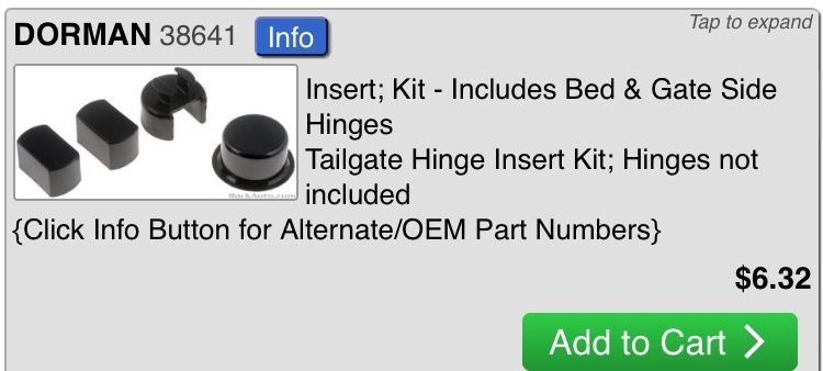

Is this what you’re missing?
Yes! They will work on my '97. Thanks for the info. I'll ck out more of Dorman's offerings.

Dorman parts
Dorman Parts, Thanks
I went to my local Jobber and looked at Dorman parts. They are so darn thin, It might be better to use the bubble pack they come in. So I followed Bruce W'S idea only I fashioned a spacer out of EPDM roofing rubber. They are out of sight and it works really well. Its locked in and doesn't rattle. It works and will last a lot longer than I think the Dorman parts would last. Thanks Bruce.
