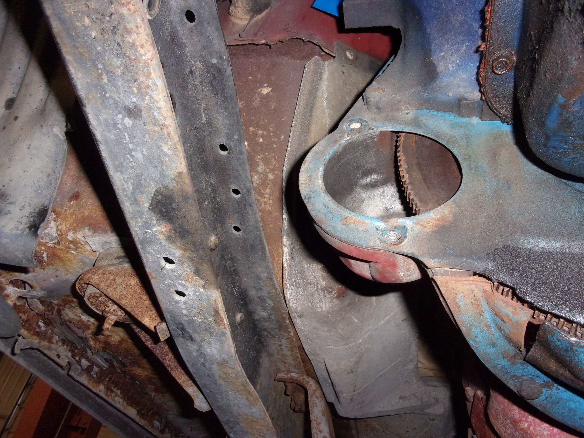

well on the passenger side the inner header tube wont fit between the bellhousing where the starter goes and the frame if I could get to the hollow spot inside the tubes I believe it would fit around the starter and bellhousing but I cant get the angle to make it get through. it lacks like an inch. I even picked the whole engine up unbolted the trans/transfercase mount and moved it all as far to the drivers side as I could and the geometery still didn't allow it to position itself correctly. I am going to try bending the inner tube to see if it lets me in. im baffled.

bottleneck
the bottleneck

The passenger side is tight.
I had to notch the frame a little on mine - which is perfectly acceptable/normal to do.
Not sure if these photos will help or not, but I already had them uploaded to Photobucket. You can sort of see the starter clearance.
I ended up notching about a 1/4" in two places.
