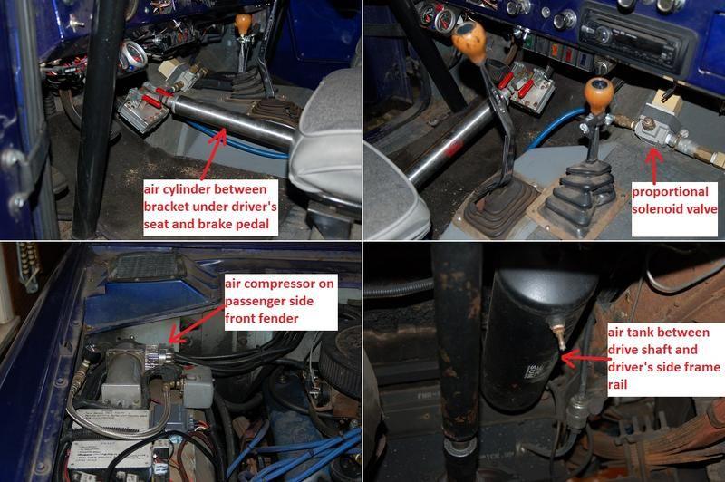

I had to get a trailer brake controller installed for towing the Bronco. The motorhome brakes work pretty well to stop the whole thing, but a trailer over 4000 lbs (which the Bronco is) needs trailer brakes to be legal. And it's a really good idea anyway. I'd set up the Bronco with "toad" brakes (brakes on a "towed" vehicle) where an air cylinder pushes the Bronco brake pedal, and it's controlled by a conventional trailer brake controller.
After a little head scratching about where to put the controller https://www.ford-trucks.com/forums/1...5-e-450-a.html, I ended up putting it on top of the dash, against the driver's side "A" pillar. It's out of the way but still very accessible. The wiring is a little more visible than I'd prefer, but it's not too bad.
Here's a picture of the brake controller installed, and one of the toad brake setup in the Bronco. The Bronco has a 12V compressor that powers the toad brakes (a 12V feed from the tow rig keeps the Bronco battery from being drained). And a proportional solenoid delivers more air pressure to the cylinder when it gets more voltage from the brake controller.
(The Bronco pictures are old, from before I swapped in an NV3550 5 speed and Atlas transfer case)
