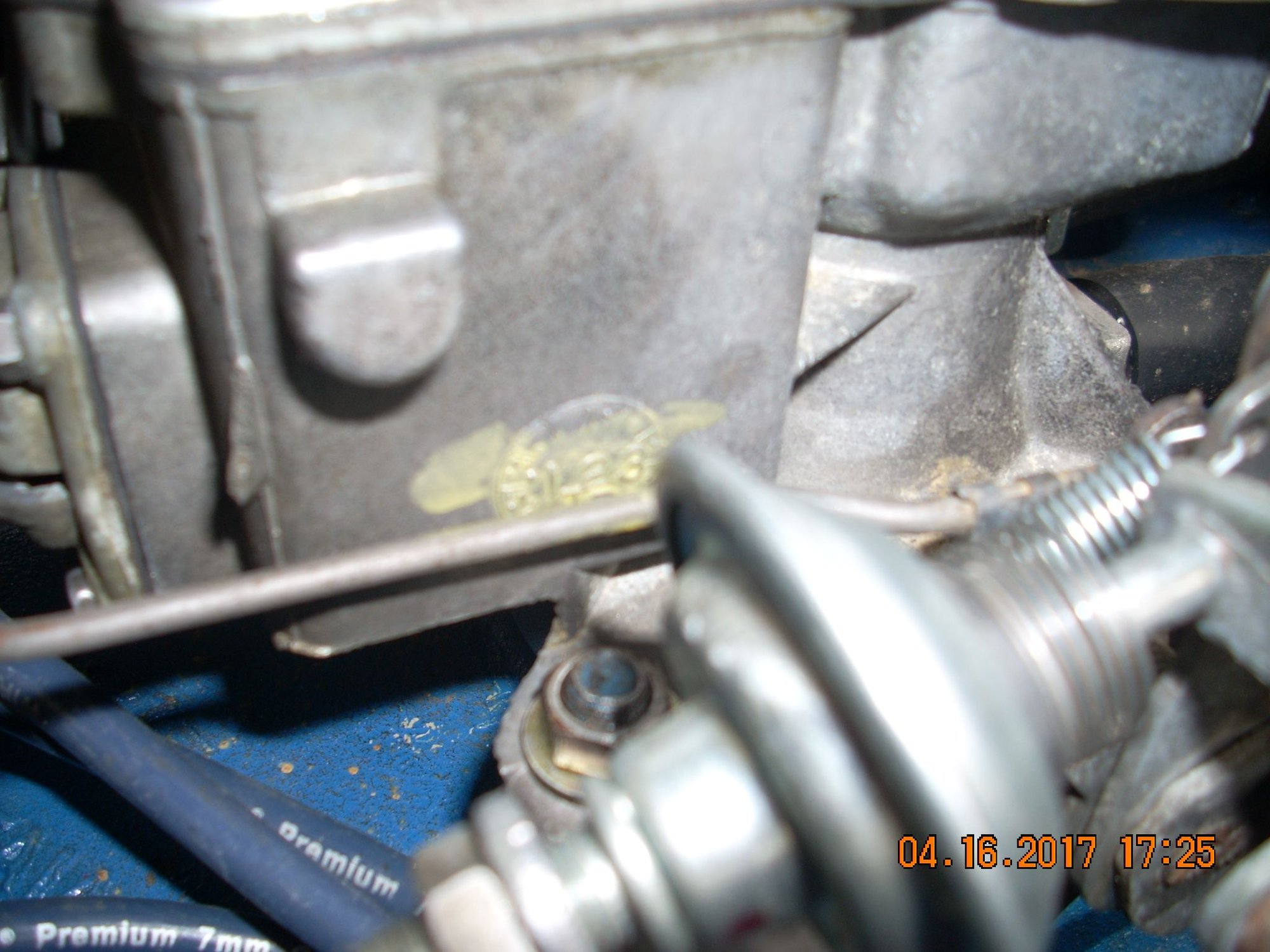

Originally Posted by RichS2659
What is the venturi size of your carb which is stamped on the airhorn. 302's used the 1.08 which is 287 cfm. 1.21 is 351 cfm.
Where exactly is this stamping? I don't see any.
It looks like 1.23 to me.
