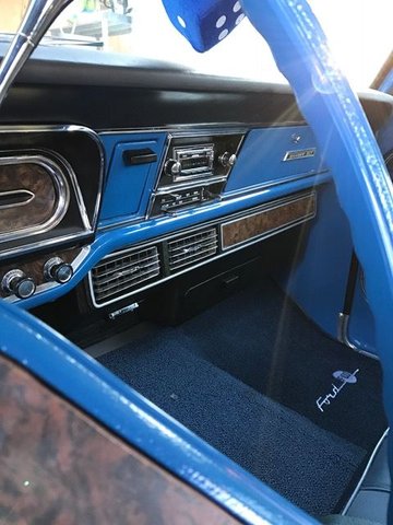

Yeah I'm exploring all options, if I did switch to R134A I'll change Compressor, dryer, orifice tube and hoses, even my fan motor. I already knew about the leakage issue, no biggie to need a recharge every so often. I can do these myself as I've installed a complete system before, but I'll see if I'm up to it. I see you can still find R12. A wide price range, mostly sky high though, so I can go that way as well, if it cost effective. The previous owner (my brother in law) said it worked fine until the compressor went out. I'm going to check if it's still under pressure, if it is that's a good sign to stay with R12. Another interesting thing, while shopping for a compressor I thought it had a 360, wasn't positive so I checked, it has the 390. Although it didn't matter for the compressor it would have been a big deal for other parts.

I'm keeping it as close to original as possible, but lets face it these trucks will never be 100% original. I live in south Louisiana and it ain't exactly cool, my daughter lives in Florida so I feel ya'.

Do definitely change the dryer. No matter which system you install. As soon as a system is opened up the dryer (or accumulator) should be changed. Freon sucks moisture out of the air fast like brake fluid. Or if the system is completely empty and open the free air's moisture in the hoses and cores needs to be trapped in a new dryer.

I'm going to bleed the system so yeah that's a good idea, thanks for reminding me. If I install the new parts I'll have it put under vacuum then charged. Right now I'm waiting for new eagle rims center caps to come in (they got damaged while taking it off a trailer I was told) so I can change my tires. At 50 the front end and steering wheel shakes badly. I was advised to try that first since the truck sat up for a long time. If that doesn't work, then front end problems. I have the original two piece rims with caps and tires but those tires look to be in bad shape otherwise I'd try them out first. A blow out with two piece rims at highway speeds ain't pretty.
