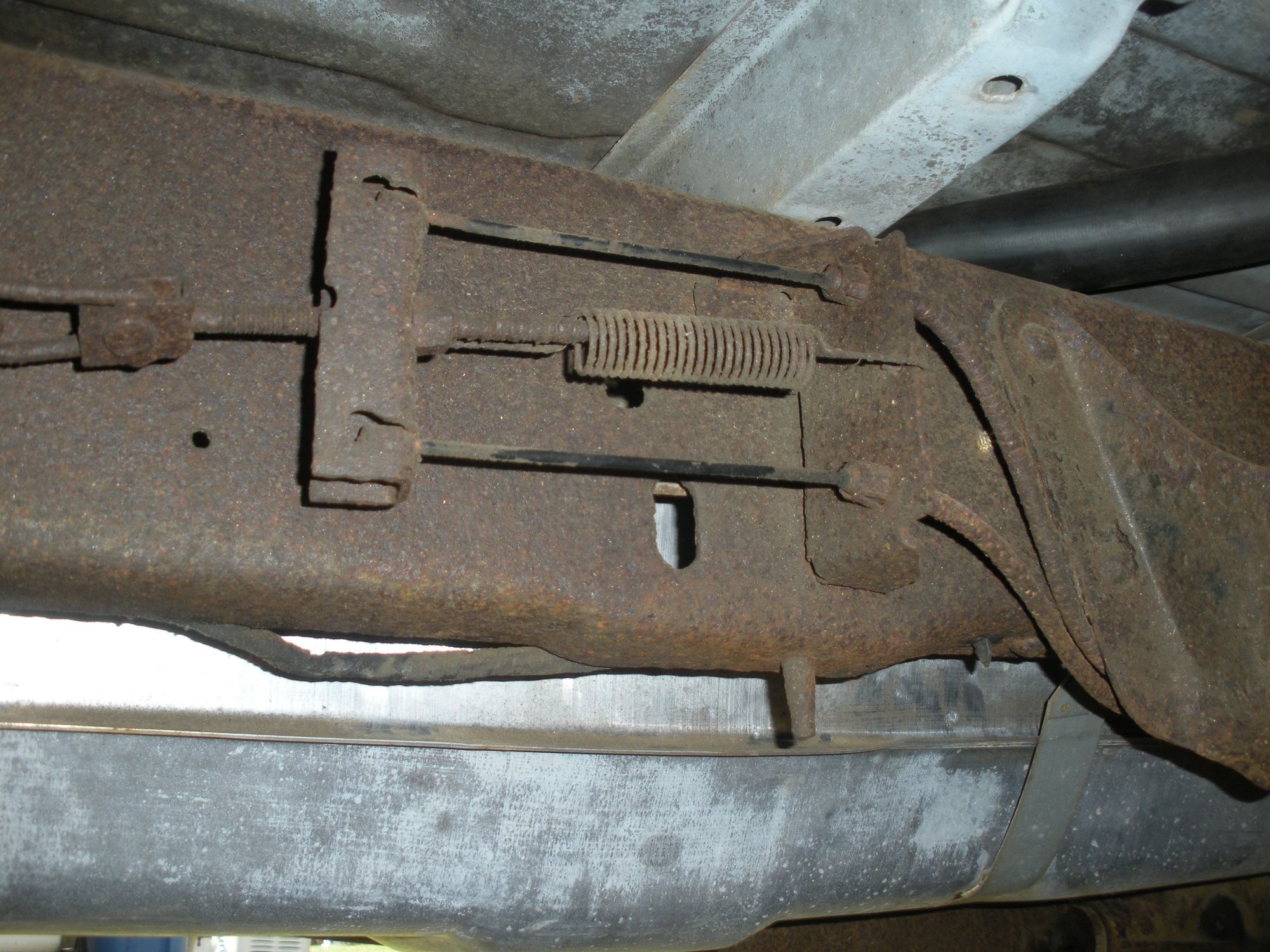

Mine the springs at the lever were too long as seen here.
I had to cut the spring so it would not droop down. I may still need to make it a little shorter when I put the ebrake on the spring may go into coil bind and not pull on the lever.
Dave ----
Those were boxed wrong or something. All the ones I have bought fit perfectly.
Then both sides were boxed wrong as they were both like that.
Originally Posted by madpogue
Actually, once you connect the intermediate/front cables and there's tension on the whole cable system, I **THINK** that slack would go away.
Then I think they would go into coil bind. That is were the spring is compressed that it can not be compressed any more.
In that picture the lever is back as far as it can go to give it room.
I **think** that's what would happen and why I cut the spring shorter.
Dave ----

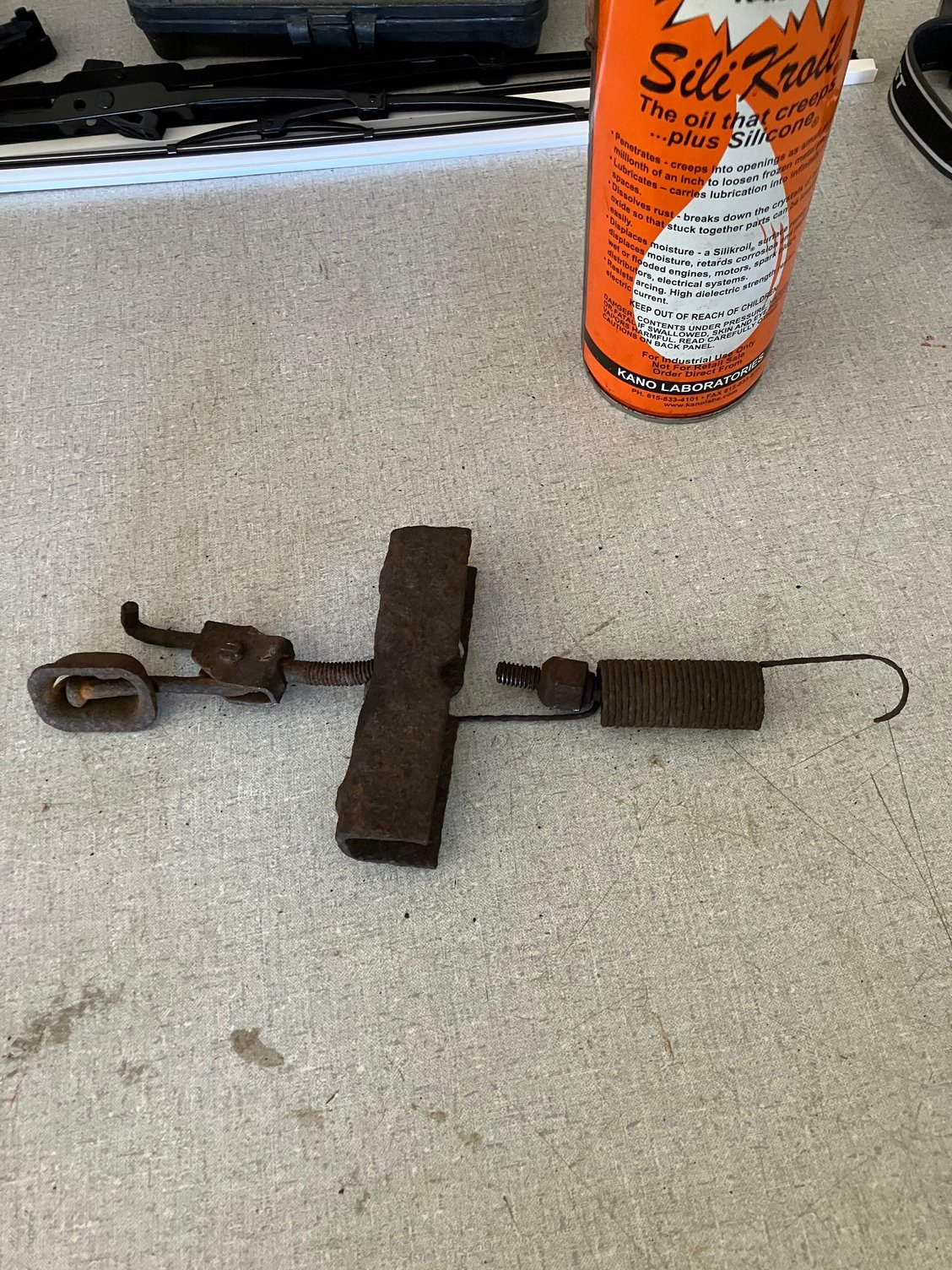

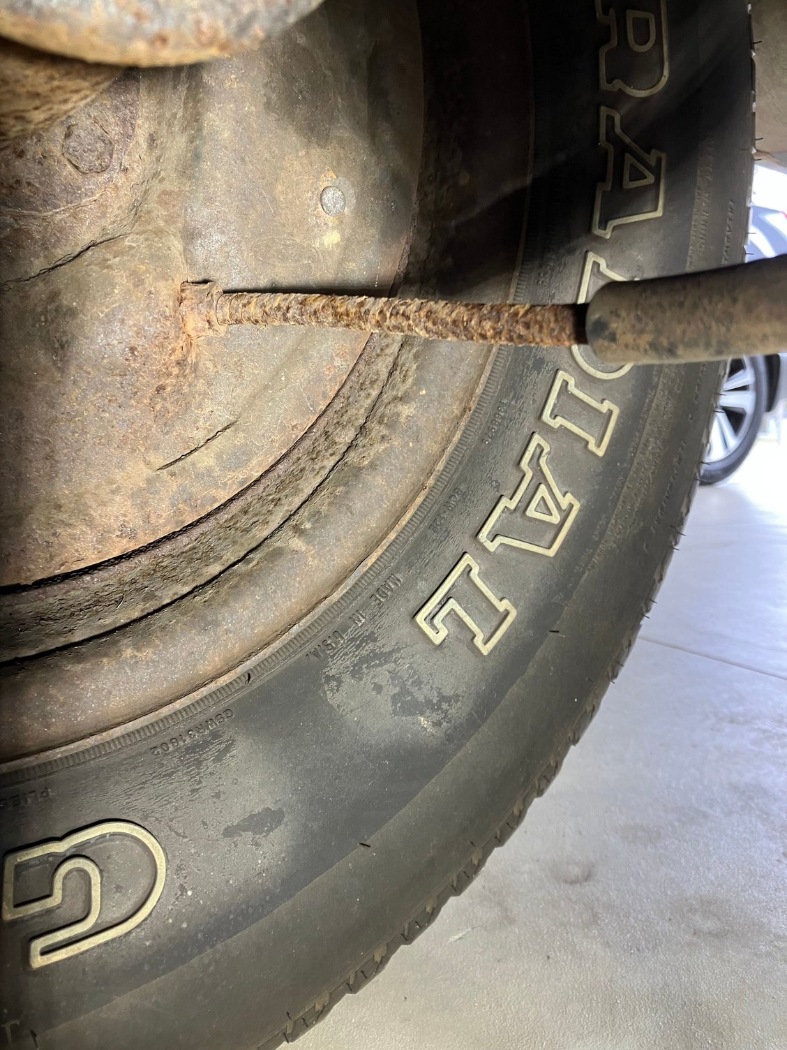

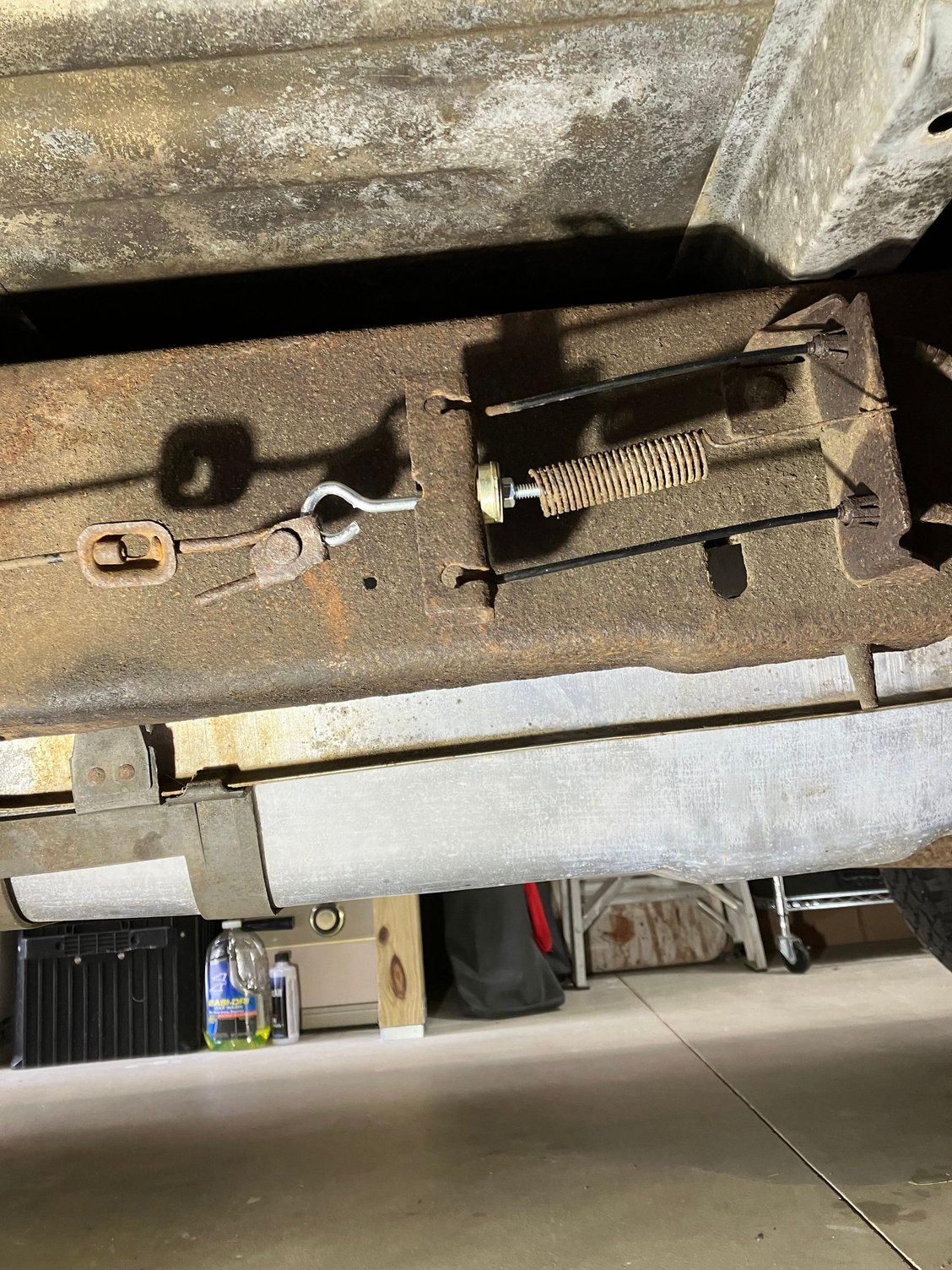

After some 30 years of never using the parking brake, I've decided it's a good time to fix the frozen cables. The only issue currently, I have removed the old adjuster, in pieces.
BTW, I was surprised that after disconnecting the adjuster, from the cable and E bake pedal move freely.
Me being cheap, yeah, I know it's an old guy thing... I figured there must be a cheaper way then some $25-45.00 for a replacement. So while driving around today with the broken parts next to me on the seat, I got a brainstorm idea. Cost me a whole $1.90 w/tax, at the hardware store. I had the various washers on the shelf.
Over the next few weeks, I'll swing by NAPA and get the two rear cables and replace them. I did spray them with the Aero-Kroil from the first photo after taking this photo. I also sprayed the clamp bolt on the frame too. I'm sure that will be fun to remove when the time comes, I think the impact gun will make fast work of it. (sorry, no picture of that yet)

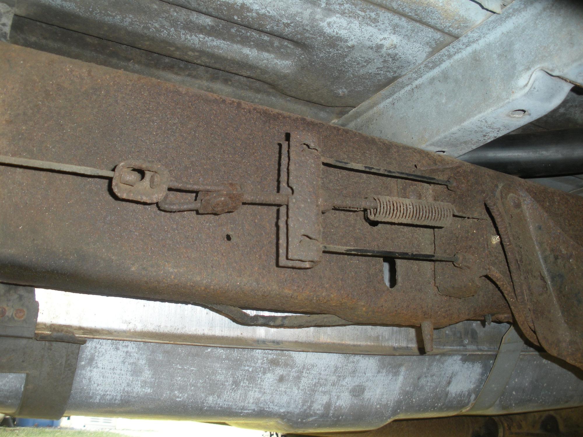

Here's from 5 years ago,

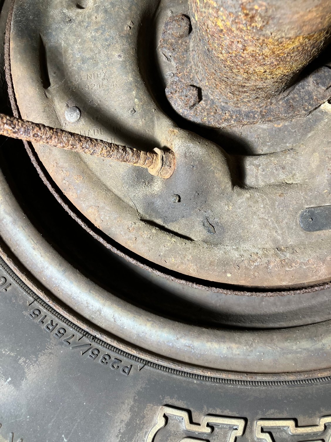

Your have to pull the wheels off and tear the brakes down to replace the cables. A lot of work, but worth it if you have a manual transmission or you tow with it.
Old Apr 15, 2025 | 03:44 PM
Max Capacity's Avatar
Max Capacity
Joined: Jun 2013
Posts: 5,667
Likes: 1,159
From: Tolland, CT
Don't do either of that. Didn't know they had to come apart to just replace the cable. Not that that is not something I can't do. Figured I could pull the drums and reach in and unclip the cable, or cut the old cable and fish in the new. With nice weather coming, it's a good project...
