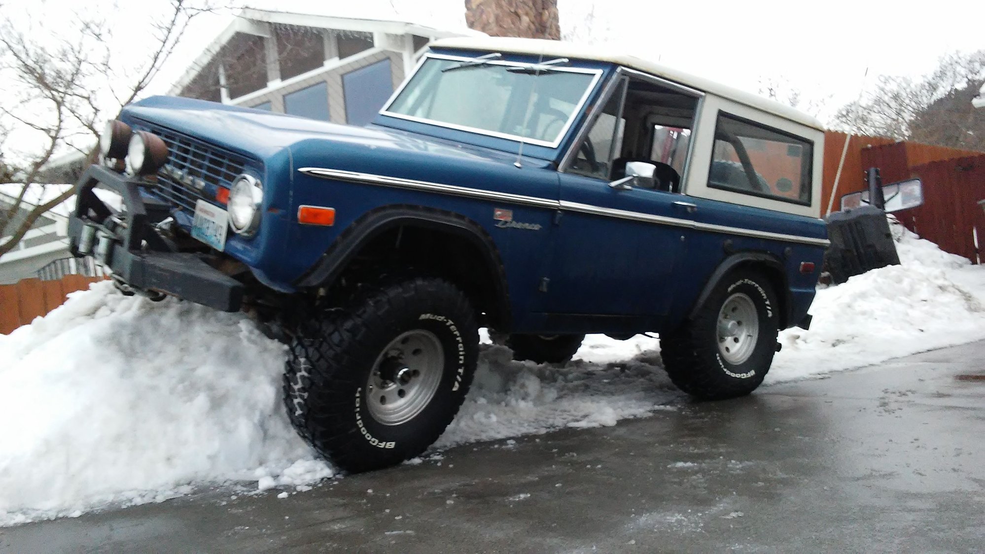

My '71 has about a 3" suspension lift and about a 1" body lift. With cutout rear fenders it has plenty of room for the 33/10.50 - 15s that I have on it. I bought it with 33/12.50-15 which also cleared. I'm not sure if 35s would rub on it or not, but it'd be close.
Here mine is with the 33/10.50-15. Not flexed much, but the most I have a picture of.
And here it is in the driveway on 33/12.50-15.

Bob, Thanks for that info. On the photo with the 12.5 X33's are you running 8" or 10" rims?

Sorry, I don't know what they were. They came on the Bronco when I bought it and left with my CJ5 when I sold that 2 or 3 years later (11 years ago).

The '76 and '77 EB's (assuming their stock front Dana 44 and disc brakes that is) need to keep the wheel backspacing within reason. I think 3 5/8" is generally accepted as the maximum without resorting to spacers to add clearance between the inner wheel edge and the tie-rod ends.
The wheels on Nothing Special's old setup look like 10" wide wheels. The ones on dclack's setup look like 8's
There is no guarantee of either of those being the case of course, as the appearance of depth on a wheel is very much changed with different offsets/backspacing measurements.
But given certain common layouts, they look like 10's and 8's to me.
