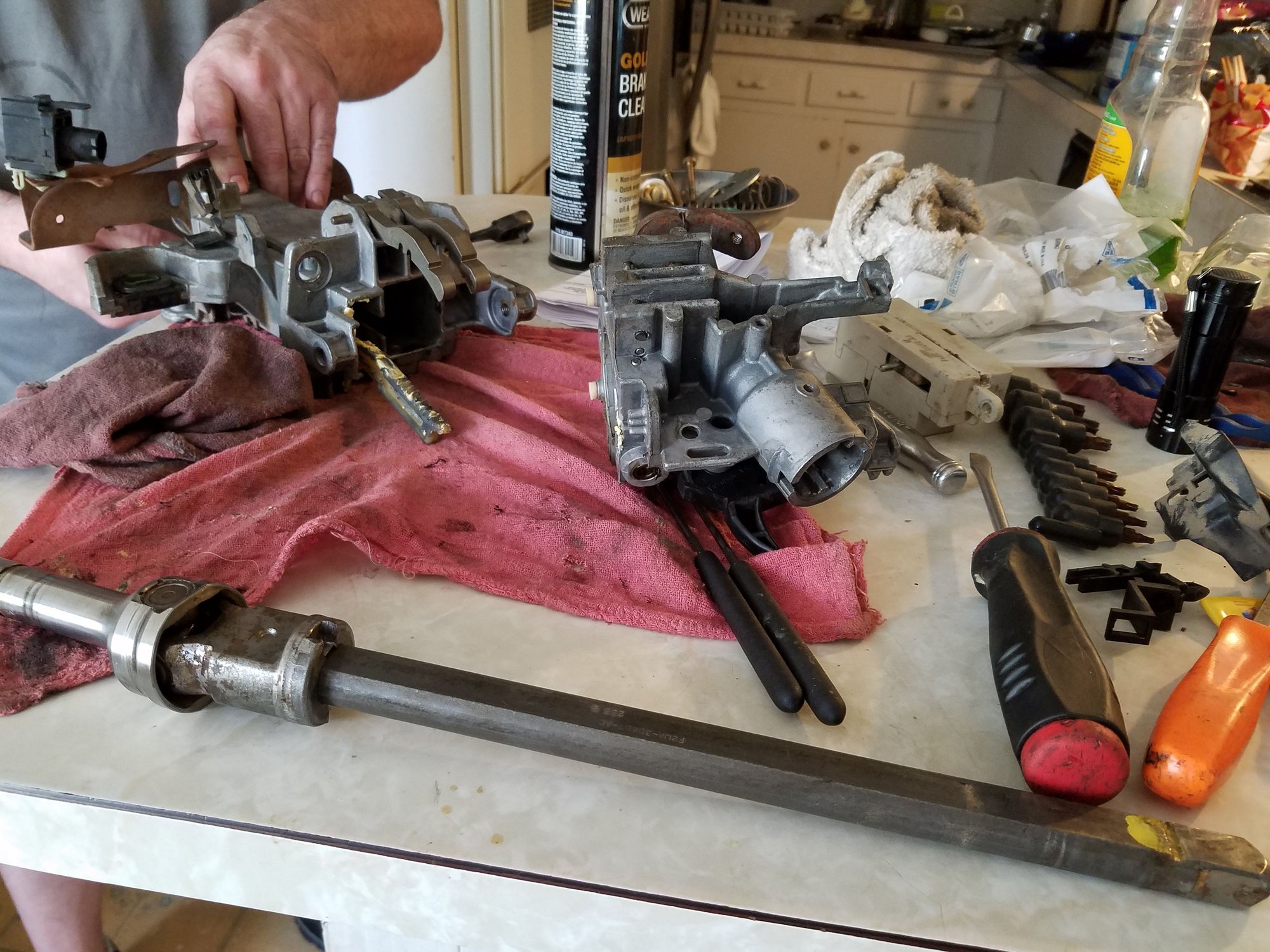

Top picture is the column disassembled. Bottom picture is a the big bearing in the bottom of the steering shaft. It is one of three. One large and two small. We are in the process of cleaning and lubricating everything.
