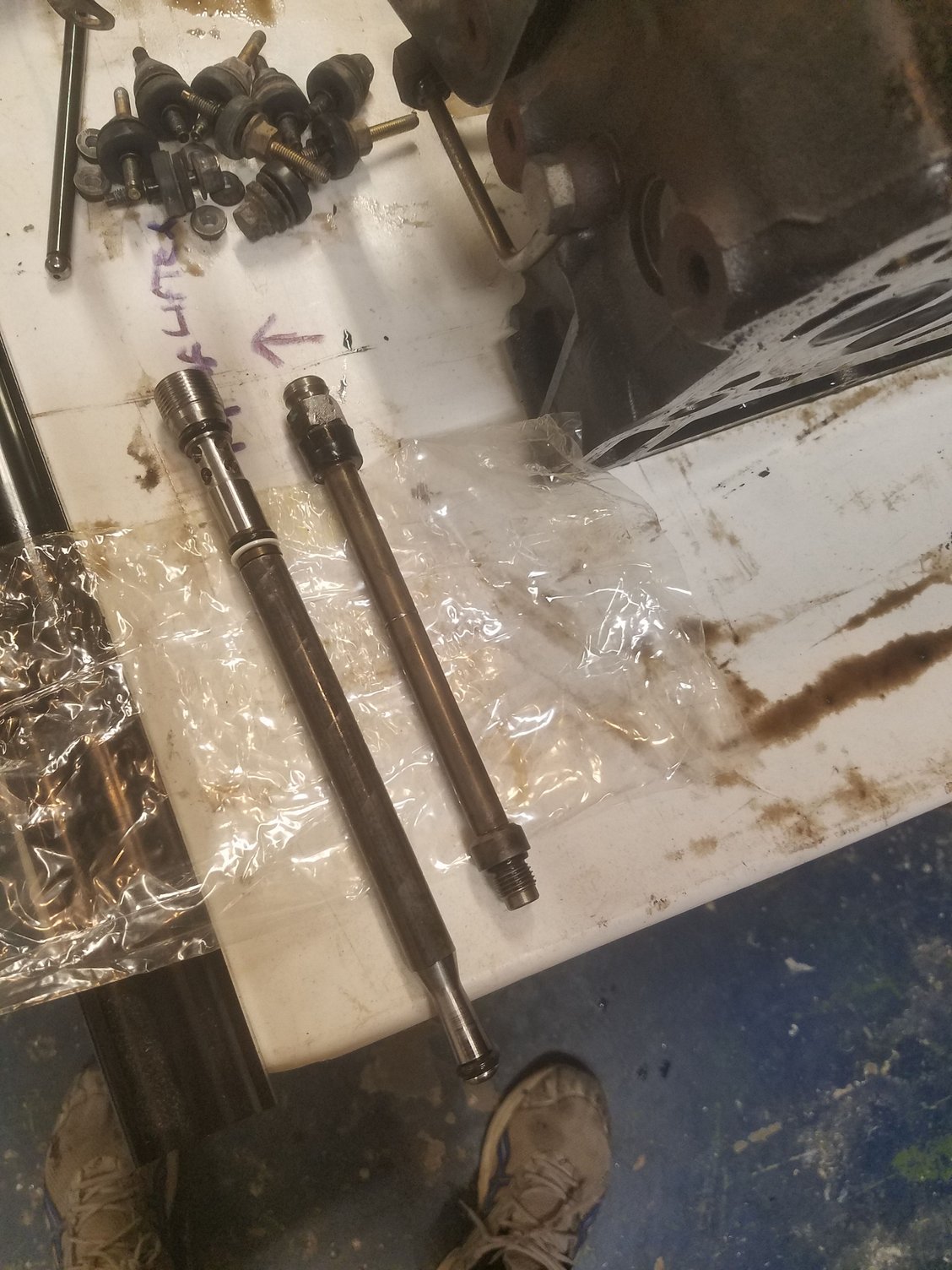

One on the lwft came with the gaskets. One on the right was in my head. Theu obviously dont match. Did i get the wrong one or is this not the right thing at all? Any help will be appreciated as i have the head off now.

The one on the right is the old style,the one on the left is the updated version.

The one on the right is for an early model 6.0, 2003. The one of the left is for a late model 6.0. with wavy oil rails.
So YES, WRONG ONE.

That really blows...like really...wonder how bad Ford is gonna get me for them I can't wait for them to ship the right ones.

TUBE - FUEL SUPPLY - FORD (3C3Z-9A332-AA)
78 bux
Tube - Fuel Supply | Genuine Ford | 3C3Z-9A332-AA : AutoNation Ford White Bear Lake | Parts & Accessories

If the tubes are fine and you want to just replace the orings, there is a guy that offers a kit that seems decent but I have no personal experience with using his kit. Here's a link to eBay.
http://http://www.ebay.com/itm/191439707915
As far as I know Ford doesn't sell the orings alone, just the assembly like I listed above.
Best of luck to you finding them quick.
