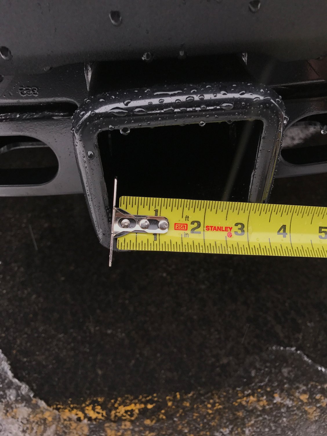

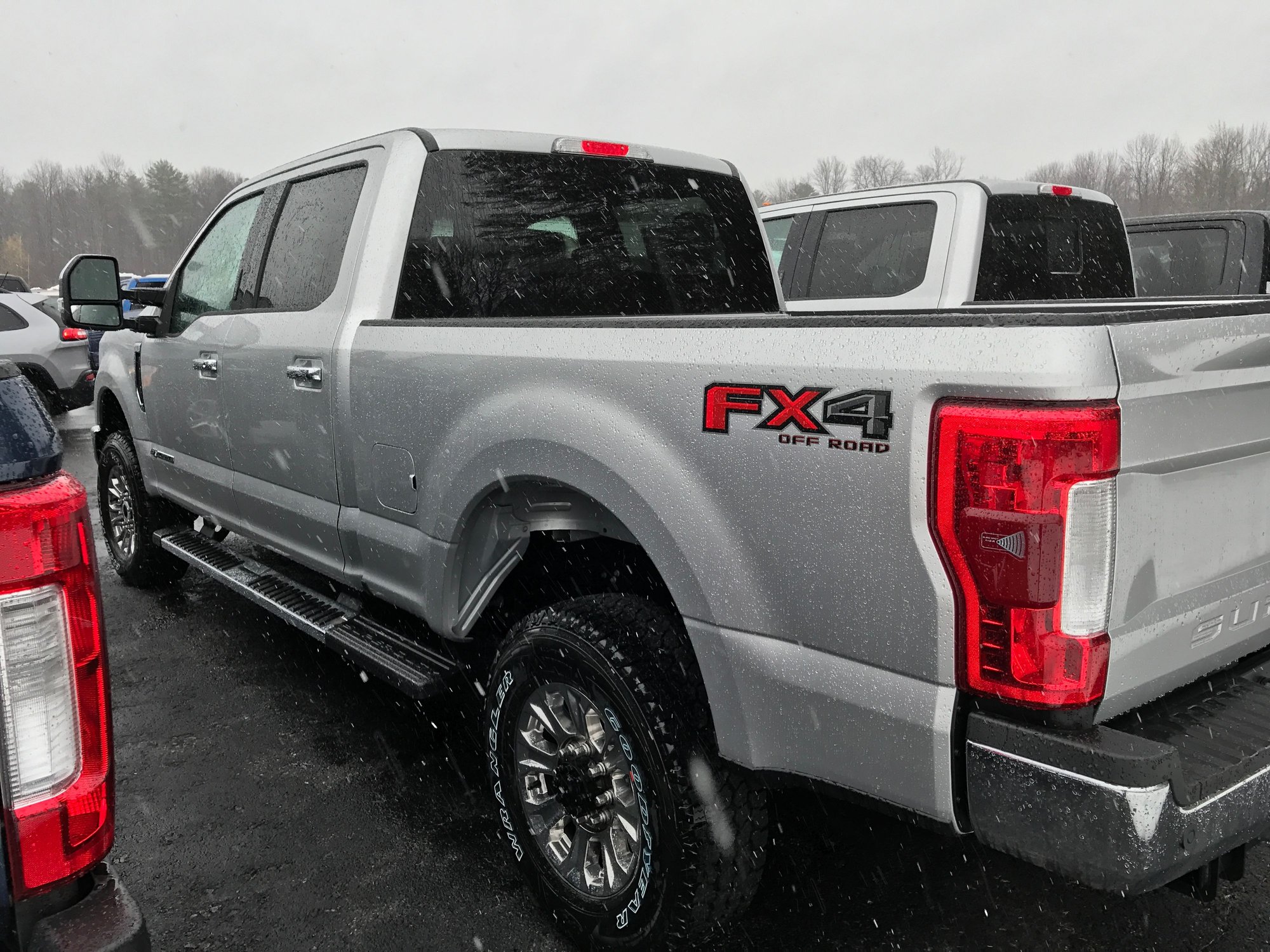

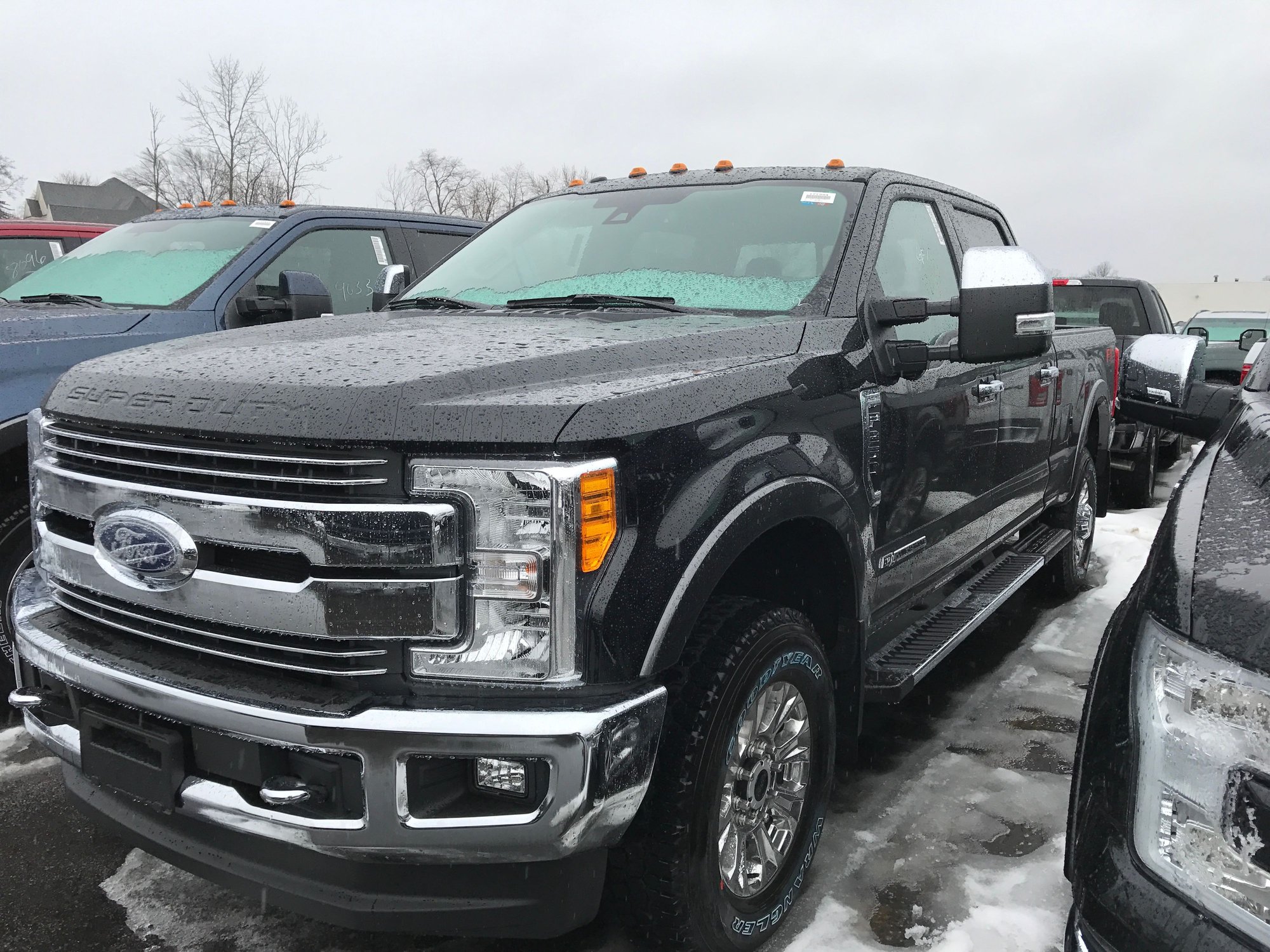

Okay Guys,
I had to run around this afternoon so I decided I would stop at every ford dealer during my travel to see what the receiver setups were on the F-250 & 350's that were available on the lots.
First truck I found with 3" receiver was a F-350 with a 6.7, 160" wheel base.
Second Truck I found was a F-250 with the 6.7 and the High capacity tow package, this did have a 3" receiver.
So from what I see on the lots... Standard f-250's without the high capacity tow package (which is only available with the 6.7) comes with a 2 1/2..
F-250's with the high capacity tow package comes with 3" receiver
F-350's with the 6.7 come with 3" receiver
I cannot confirm if a f-350 with a gas engine comes with a 3" or if you have a long bed because I could not find that on lots.

The 350 you checked was job 1. For job 2, the 3" is gone on short bed 6.7 SRW 350's. It's been confirmed by those with job 2 350's...
The only thing that wasn't confirmed was the job 2 short bed HD 250 which has now been confirmed as well.
