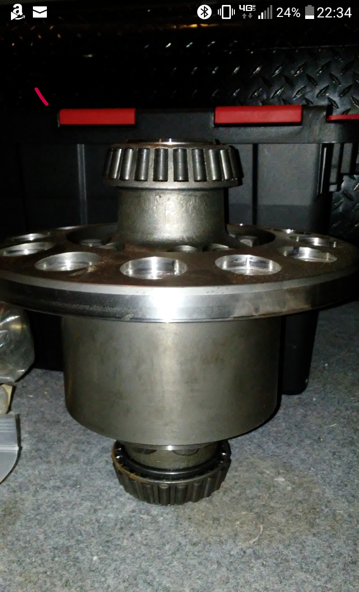

Any pick of that bad boy, Y2? Maybe someone here in SoCal don't know they gots a gem, their dumping on clist

See the avatar to the left of my user name.
And if you have xray vision, you can peer through the welded on rear cover and see those helical cut anti slip gears in the case.
Otherwise, no, I've never had to disassemble the third member for service, and don't expect to. With the stress distributing mechanical leverage of a 14.2 inch ring gear (current 550s run only a 12" ring gear), and not just 3 quarts, but 3 gallons capacity of synthetic axle lube (that cost over $300 for the lubricant alone, uninstalled, at $100 a gallon for the Redline snake oil I bought), I don't ever expect to have to service this rear end, ever.
