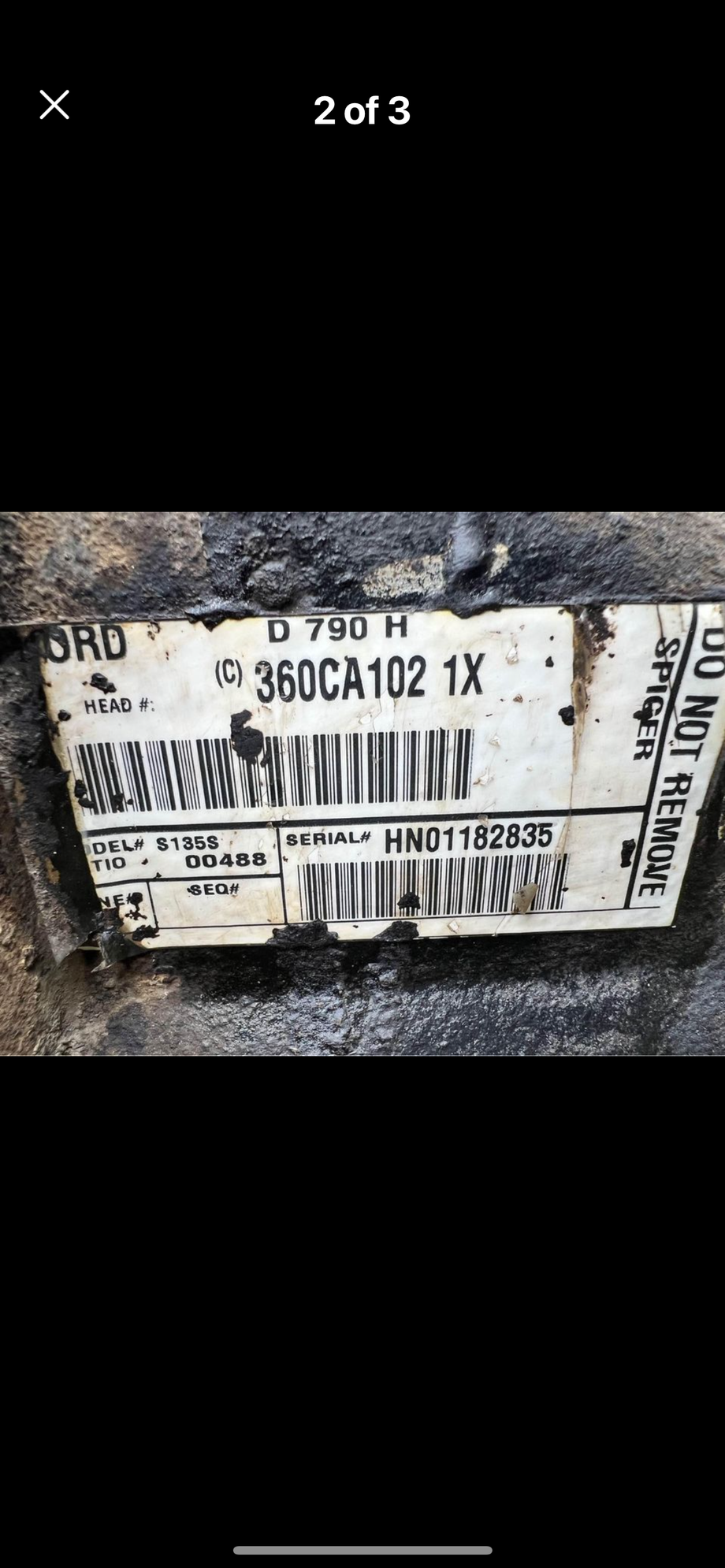

I have a Dana 80 in my f450 with the truetrac. I’m looking to buy a s135s rear end to put in my truck. I am trying to figure out if it has the truetrac in it or not as I would like to have a Truetrac in the 135 as well. I’ll attach the label.
The axle label shown in the photo above does not appear have a TrueTrac installed.
Where the label says Model "S135S" above the "00488" Ratio, it would say "S135SL" if it had a TrueTrac installed.
The appended "L" stands for Limited Slip.
The label on my S135 axle with a TrueTrac states "S135SL" in the same location where the label above says "S135S".

What particular trutrac to get
what particular truetrac will I need to get for this axle? I googled and the price is all over the place and is listing different spine counts.
