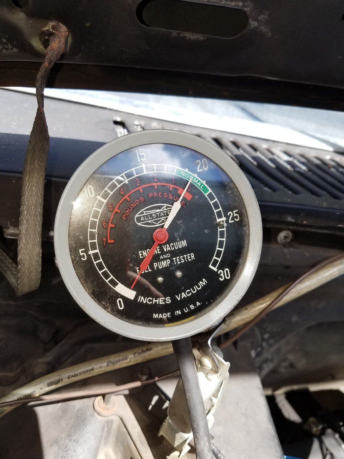

I wonder if your timing is retarded? I know you checked with the timing light, but if the harmonic balancer has shifted, that will not be accurate. Can you get a vacuum gauge and adjust the distributor for the highest vacuum? I do that on mine and then drive. If it pings under load, I retard just enough to stop the pinging. My son has a 1984 F150 with 4.9L and I have a 1986 F150 with 4.9L. His is stock and mine has been converted to Duraspark. Both pull ~21.5" Hg @ 650 RPMs. Both have 1 barrel carbs.

What is your altitude? 16" might be pretty good if you're over 3 or 4k say. Also depends on the camshaft. An OEM camshaft will draw more vacuum than an aftermarket.
Agreed, adjust the distributor for maximum engine vacuum. At factory idle. Then back off about 1" of vacuum from that. This will get the initial timing very, very close to optimum for pump gas. May need to adjust the distributor advance internally, but this is a good way to set the initial timing if there's a question with the pointer or damper markings.

pulling great vacuum
