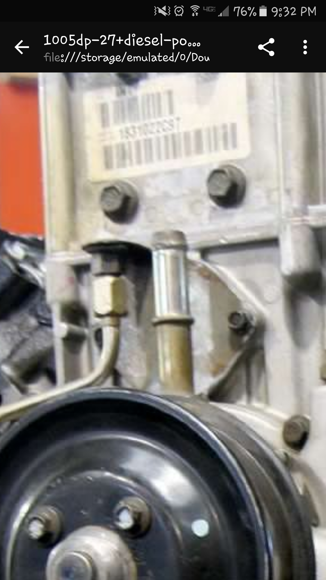

What is this part called and what seals it. Mine is leaking oil. Would take it off and look but wasn't sure what I needed to reseal it. Thanks in advance
The plate that is leaking on my truck

That is the cover plate that gives access to the bolt that holds the gear onto the HPOP and it also holds the EBP sensor and tube (which you have already discovered). There is an indentation in it that looks like it could take an O Ring but mine was sealed with that gray Ford sealant that they use to seal the plenums. You could probably use some other sealants as well but I don't know which ones.

Looks like the HPOP to me.

Ok I'll pull it and use some sealant. Trying to fix a couple small leaks

pretty sure this is the recommended stuff.
Motorcraft TA31 RTV Silicone Sealant
If it was me I would try what I had on hand that said oil resistant(permatex black?) then if it didn't seal spend the money on the good stuff
