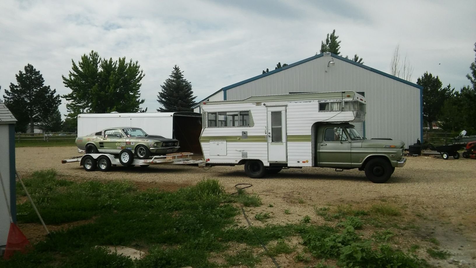

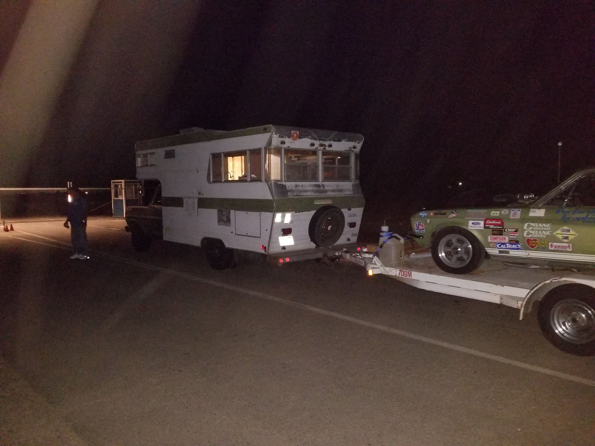

I'm still around!
Picture of the trip 6 years ago. Start from, Middleton Idaho to Woodburn Oregon, 635 miles .
The F350 Caveman will run at 70 mph (faster down hill). Copilot caught me running at 75 miles an hour a couple of times and reminded me, I said that I wanted to keep it under 70 mile an hour...
It has a 2 barrel Holey 500 CFM on a 390 FE with a C6. Filled up with Gas in Middleton and It made it almost to Woodburn, filled back up in Portland. Trip was almost 8 hours. It does have a 28 gallon tank under the bed and 2 50 gallon tanks at the back end...
