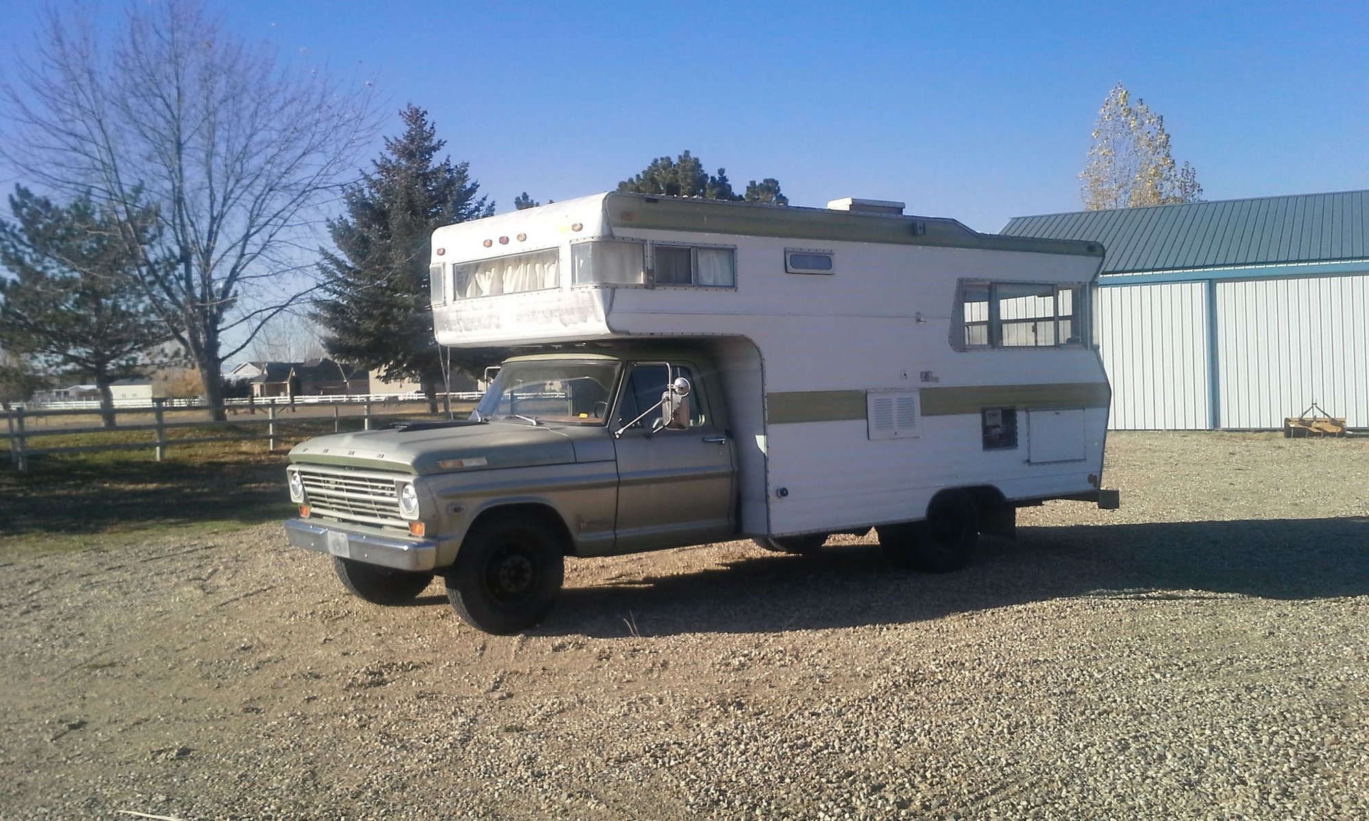

Dietz Side marker light
While I was checking the lights on my F350 Motor home, found that the side lamps on the front fenders were not working, removed the Lens and no bulb. Saw 2 contacts in the socket and "ASSUMED" that a 1157 bulb would work. Nope wont fit. OK next I tried a 1158 center contact bulb OOPS apparently one of the socket contacts is ground and one is hot...
Melted the contact plate and an now I need a bulb holder or complete side Amber marker light. It is a Dietz 94 Marker, Plate is marked 94-3.
The other side does not have a bulb. What is the correct bulb number?
Any help is appreciated.

Good info Garykip but the light he has has been added and is not original equipment, or even made by Ford.

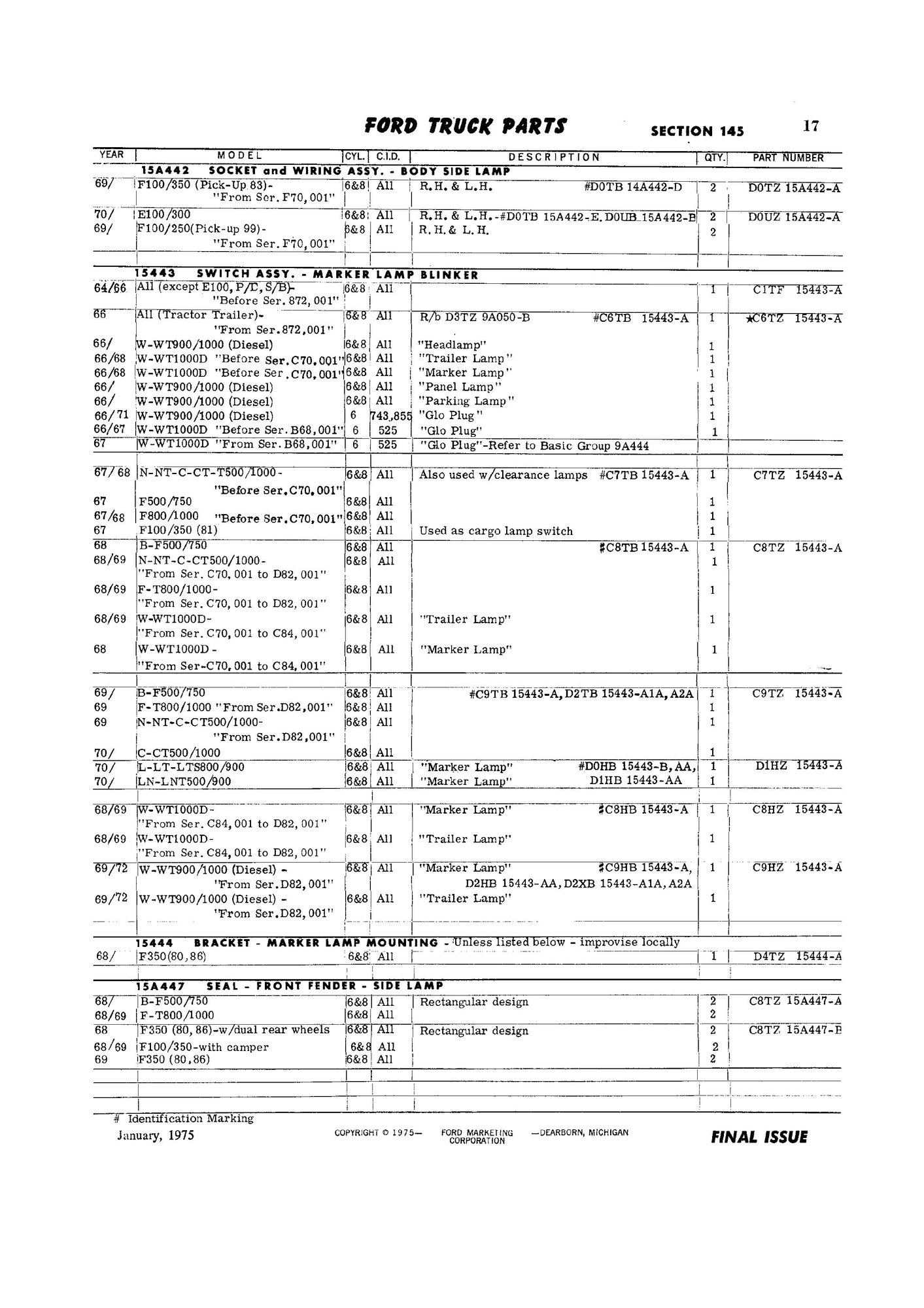

Originally Posted by willowbilly3
...but the light he has been added and is not original equipment or even made by Ford.
It is original equipment, but over 80% of the parts on these trucks were not made by Ford. Ford designed/blueprinted them, then contracted with outside suppliers to make them.
C3AZ-13466-G .. #97 bulb-Use with C9TZ-15442-D (replaced C8TZ-15442-B) Amber Rectangular Front Fender Marker Lamp / Obsolete
1968/72: F250/350 Camper Special; F350 Platform (flat bed) & Platform & Rack (stake bed) with dual rear wheels; B/F500/750.
See 15442 in upper pic:
C3AZ13466G ..#97 bulb is a single contact bulb Bill. So it won't work in the 15442 Camper Special fender lamps. They fit in the platform bed and flat bed marker lamps front, sides, and rear.
