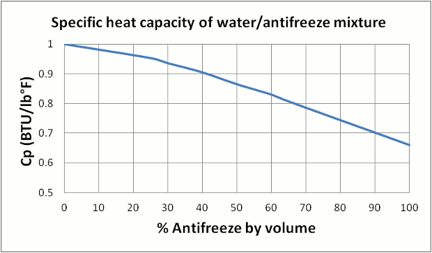

Originally Posted by Mixer man
Straight antifreeze can cause overheating. Geez. Your radiator guy is wrong. The only coolant that you can run straight, to my knowledge, is Evans Waterless Coolant
And diluting 50/50 antifreeze? Why? It's not 50/50 anymore. More like 5/5. 50/50 antifreeze is formulated to be run full strength. It not only protects from freezing, but overheating as well. When you dilute it you effectively lower the boiling point. With all due respect, suggest reading the labels.
^^^^ Yep. 100% ethylene glycol has 35% less heat capacity per unit than water, 20% less than a 50-50 mix.
