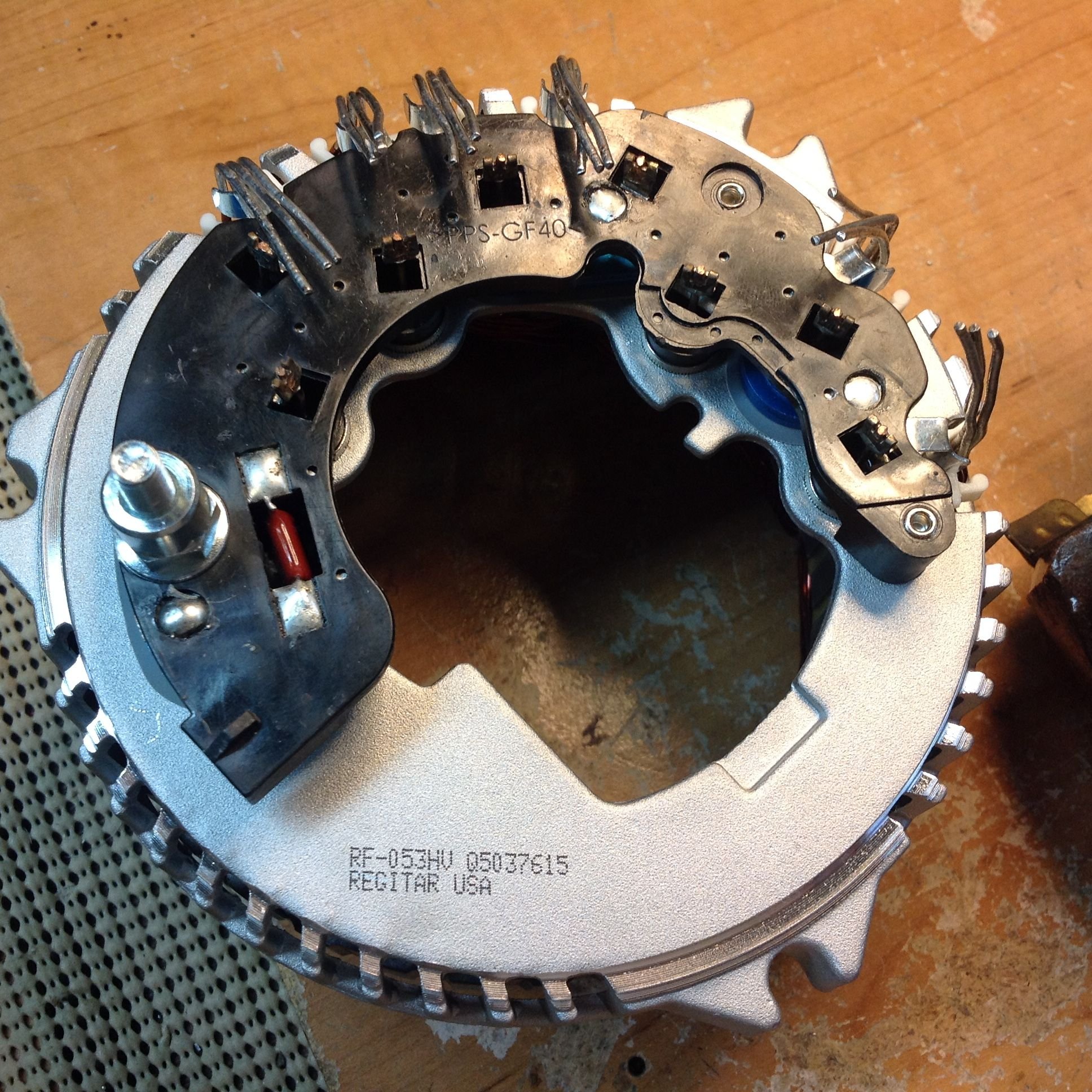

Sure will , For my application a 1992 Ford XLT Bronco, I believe it was a factory (stock)-2G alternator, with 3g starting in 1993 . My 200 amp had the 3g cases .I used new 3 g cases ,stator to fit the 3g case , along with H.D.brushes and a heavy duty rectifier .Depending on your year ride, that will matter. Some year cases were smaller in stature and most people search the bone yard for the 3g model which was 130 amp .I did find out you have two 3g cases , one being bigger .Following our 3g alts 4 g 6 g came along etc.........You tube ,search engines putting in 3g alternators will help and pictures later will follow. Good luck TR

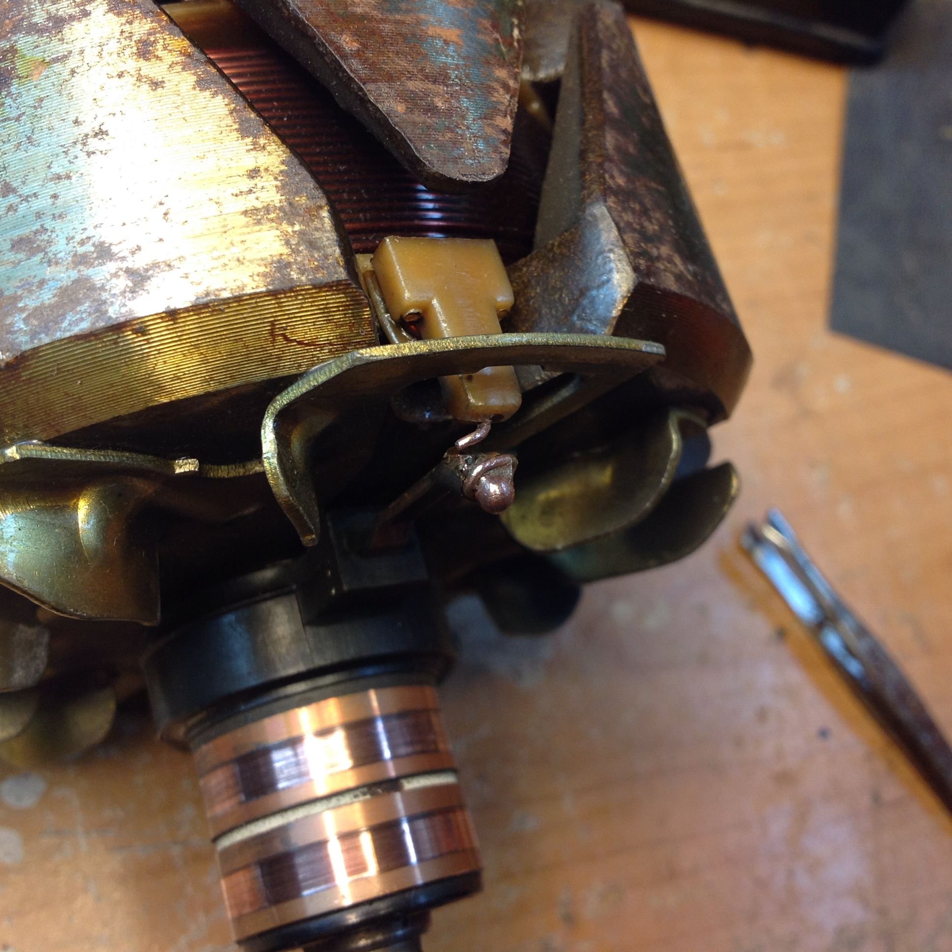

15 year old 200amp stator ,notice the wire ,soldering came loose ,at idle full charge ,revving up over idle no charge (wire was actually touching,moved away for photo)
New 275 amp coil
275 amp coil -being silver soldered

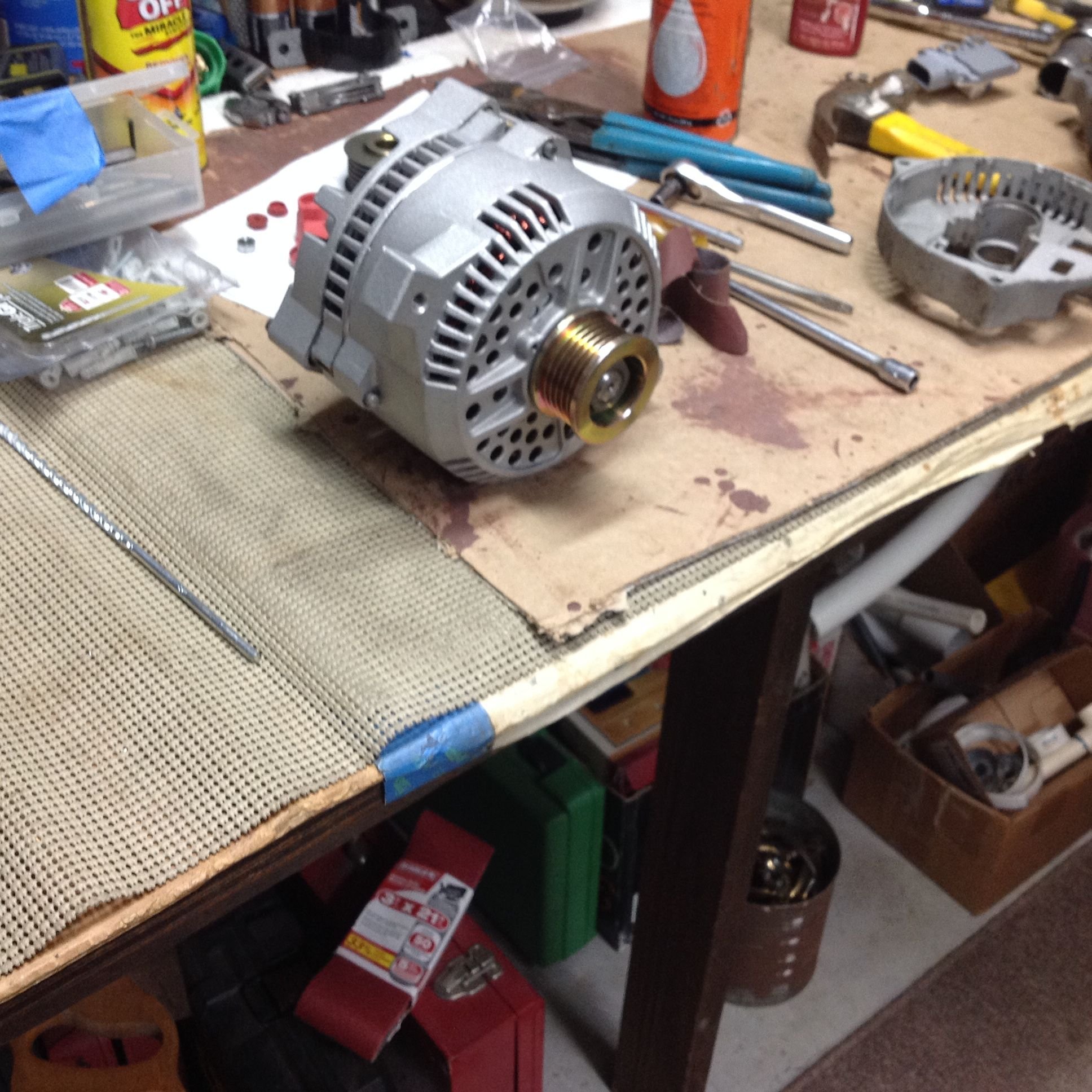

Final -275 amp alt.-1992 Ford Bronco 351 W

Found most parts on eBay- bearings ,stator ,coil ,regulator -cases from national quick start.Most mustangs use that coil/ stator.Good luck TR
