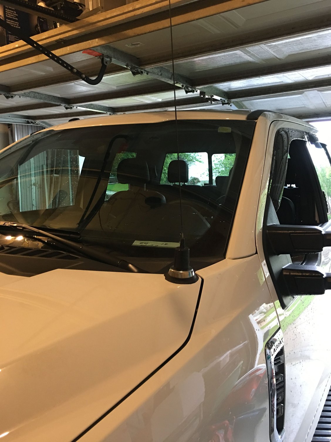

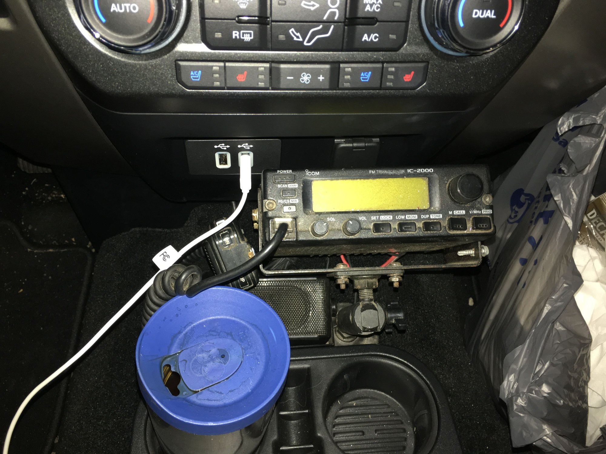

With all the flooding around recently I went ahead and got my old Icom 2000 mounted and ready to go in the truck. As previously stated I bent my clamp mount to match the hood of this truck and mounted my Larson LM150 to the hood, and mounted the radio on the pedestal mount in front of the dash on the floor (one of the reasons I didn't buy a truck with the full center console)
