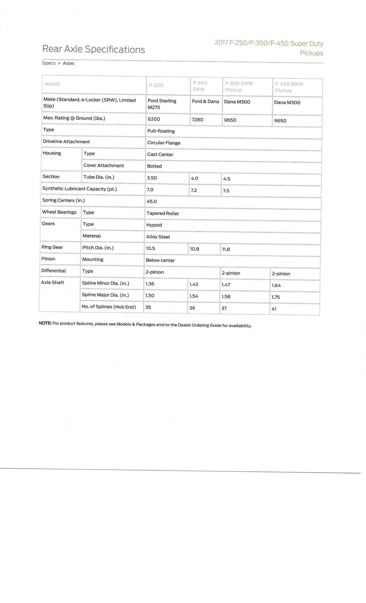

Your name suggest you will be pulling a bumper pull travel trailer ( and Im making a big assumption there) The F250 should be fine pulling most BP trailers since the hitch weigh limits how much wight you actually transfer over to the truck axles. The F250 has the same motor, tranny, brakes etc as the F350 so it will pull an equal bumper pull equally well.
The main difference of going to a F350 is how much load you want to transfer to the truck axles. ie Gooseneck or 5th trailers. Both will push the weight limit for a F250 truck. It's been argued since 1999 whether the F250 has the same axles as the F350. The spec sheets that were linked above show the F350 having 7280 lbs rear axle vs the F250 having a 6200 lbs axle. That means you will have an extra thousand pounds of load capacity with a F350. It's not in the tires, it's not in the springs. It's in the axle itself. Air bags may level the load, but they won't change the axle rating.
If you need the heavier capacity, Buy the F350.
Despite the F350 SRW's rear axle rating, the gross axle weight rating (GAWR) is determined by the weakest link, be it the axle itself, the tires, the wheels, or the springs. Accordingly, the spec sheets also include the following disclaimer:
Gross Axle Weight Rating is determined by the rated capacity of the minimum component of the axle system (axle, computerselected
springs, wheels, tires) of a specific vehicle. Front and rear GAWRs will, in all cases, sum to a number equal to or greater than the GVWR for
the particular vehicle. Maximum loaded vehicle (including passengers, equipment and payload) cannot exceed the GVW rating or GAWR
(front or rear).
These components on our new F350 4x2 have the following ratings:
Axle: 7,280#
Springs: 6,780#
18" A/S Tires: 2x 3,415# = 6,830#
18" Wheels: 2x 3,590# = 7,180#
I'll be humbly surprised if our truck's rear GAWR comes in at above 6,780# (which should be plenty, BTW).
These components for an F350 4x4 w/ 18" A/T tires present a different picture:
Axle: 7,280#
Springs: 7,230#
18" A/T Tires: 2x 3,640# = 7,280#
In this case, I'd expect for the wheels to be the limiting factor for the final rear GAWR.

It's pretty easy to PLUS size your tires and in the process get a substantial bump in tire load capacity. Jumping from 275/65R20 to 295/65R20 adds 3/4" in total tire diameter but adds 330 lbs of capacity per tire. A F350 axle adds 1000 lbs of capacity per axle. So the week link stays the actual wheel. It's really hard to find a wheel that goes above the 3590 lbs that the OEM wheel offers. I bought my Ultra wheels because they offered 3700 lbs and that was about as high as I could find in SRW.
It's your decision as to what you think the weakest link is and how confident you are in that link. I know I'm pushing the limits of a SRW truck when I haul my horses, So I've tried to up all my load capacities as much as I can. I'll live with being close to my max's vs buying a dually.
BTW here is the page from the Ford Spec book that shows the different axles. There are a lot of people who say Ford uses the same axle in both F250 and F350 trucks. I'm not here to say it is or it isn't. Just posting what Ford printing in their specs.
