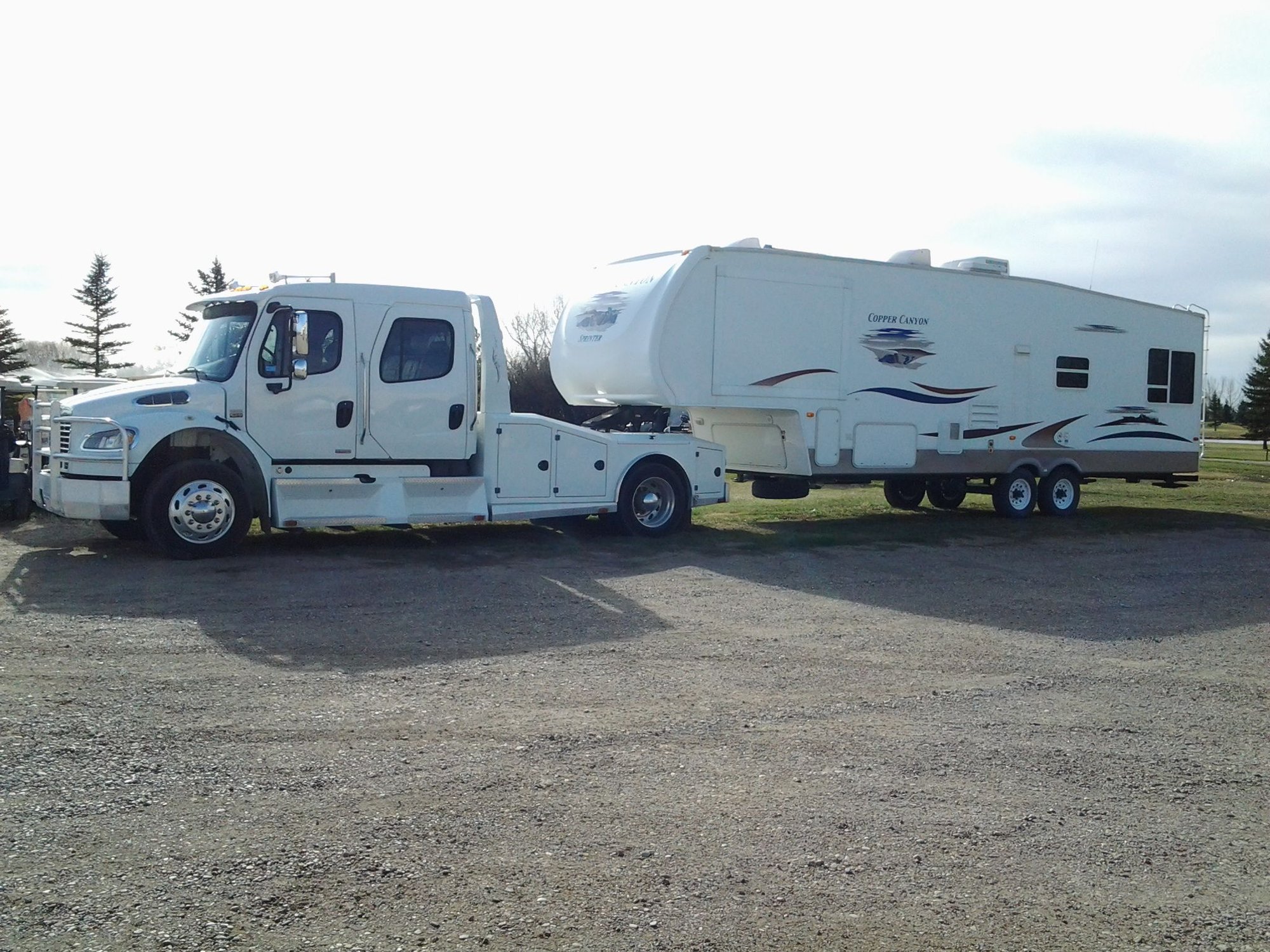

Thanks Dave. Picked up new bearings and seals yesterday. Packed and installed today. should be good to go. Supplier liked i had the numbers as he couldn't find them.
Ready for Alaska
