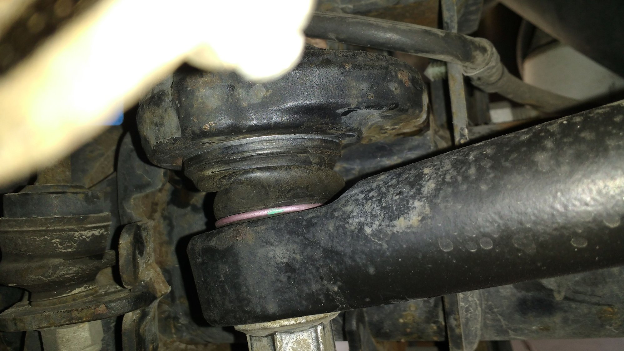

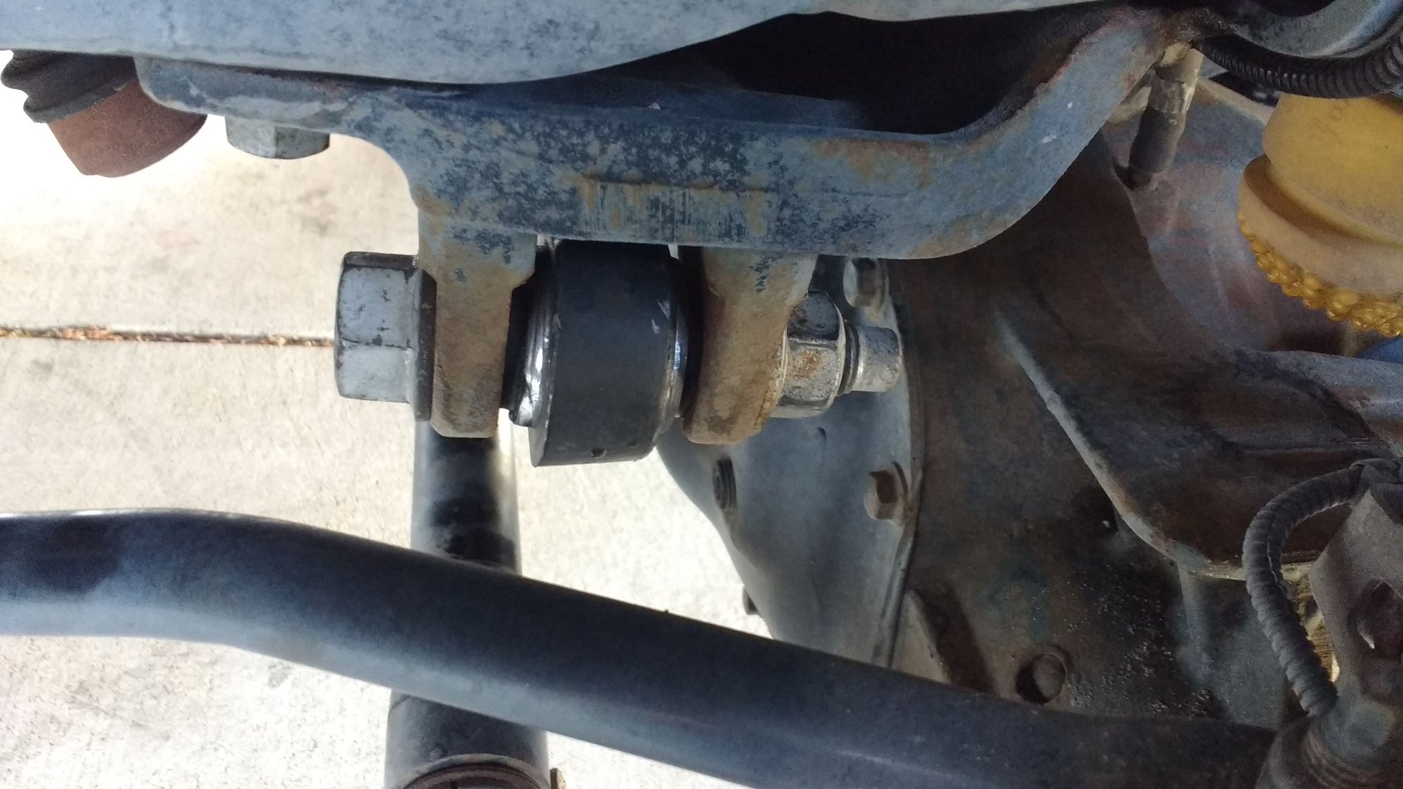

What it took
This is what they replaced. After some research it makes sense to me. There a lot of aftermarket trak bars out there that claim to cure the death wobble.
Old Mar 16, 2017 | 04:26 PM
Dakster's Avatar
Dakster
Joined: Dec 2013
Posts: 9,762
Likes: 115
I won't be surprised if all my running around in 4WD causes that same part to fail...
Glad you got it fixed and for $100, that isn't too shabby.
