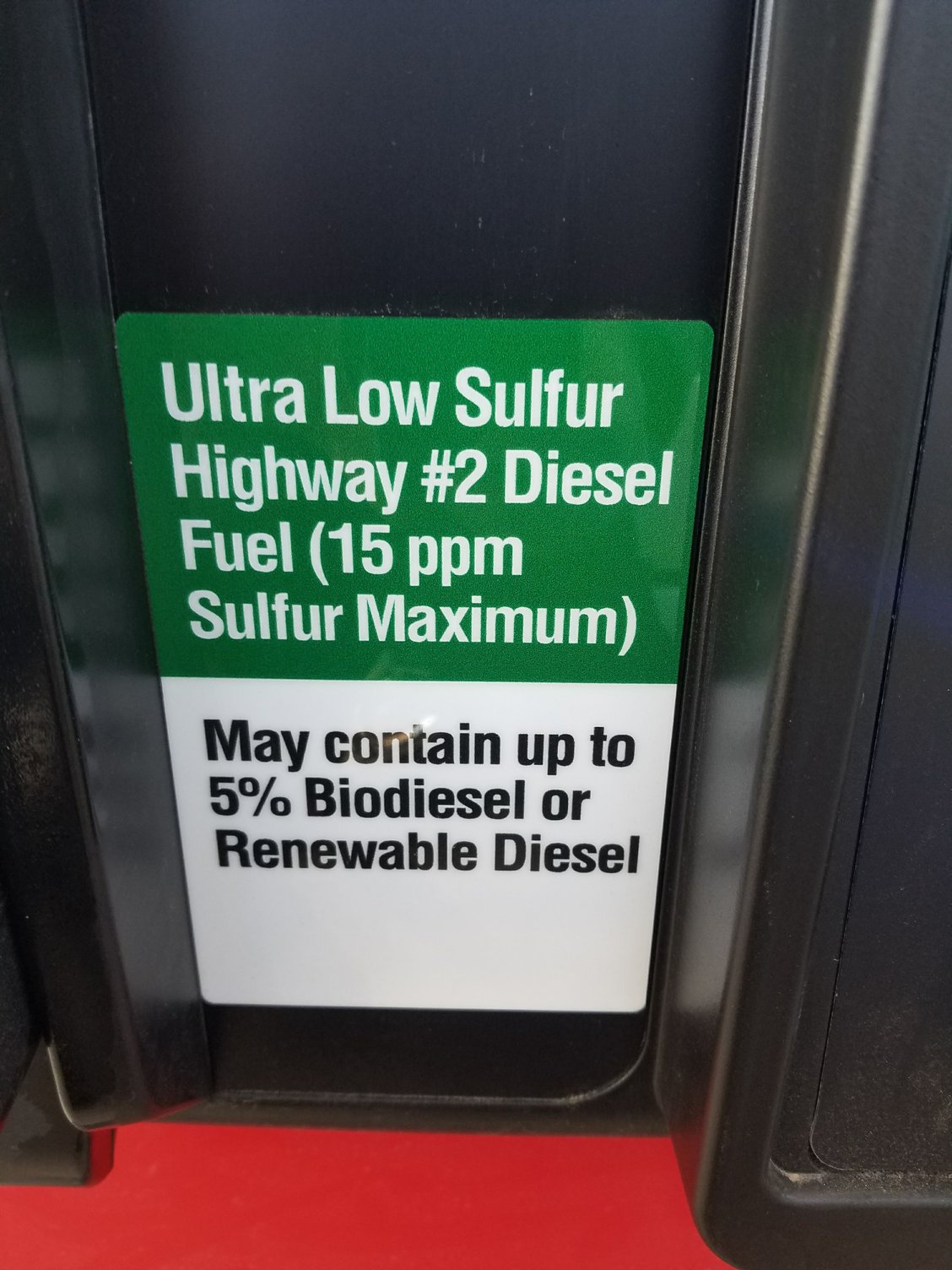

Is this considered Bio Diesel? This tag is displayed on all pumps at Quick Trip stores. From my research they sell only top tier fuels. Is this true for Diesel fuel as well?

It's part biodiesel... B5 or 5%, assuming they add it into the fuel.

That tag is a disclaimers saying their fuel MAY contain Bio diesel. So I guess they post that because they might have a source they occasionally buy from that sells them Bio-Diesel.
