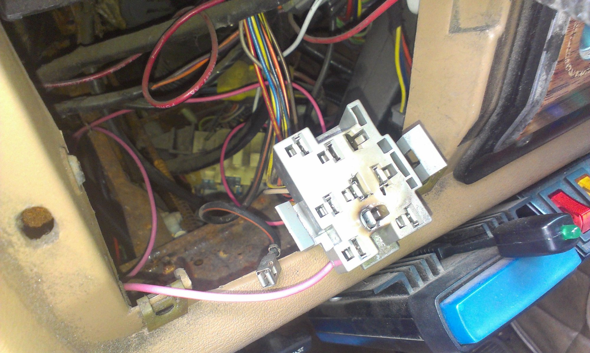

Well guys, I think I found the problem. I'm actually genuinely surprised the van drove without catching fire. Turns out the connector had melted, and not only that, but the main thicker black/red wire had fallen out of the plug. Not sure how the circuit maintained a closed circuit with that wire gone and still periodically give me headlights and high-beams, but whatever, I fixed it now.
A long time ago when I put in the replacement switch, I wired up my auxillary gauges to have a jumper from the head light cord to the gauges, so that they would dim at night. But that never worked. Now that I clipped off this melted connector, and I properly wired it to the system, not only do my headlights and high beams now work perfectly, but even my gauges properly dim. I guess all the wiring was F'ed up.

Those headlight connectors never fail to melt, all gmc/ford/dodge do it, my parking light wire melted out so I just added a spade and manually connected it, I wouldn't have enough slack to add a new plug without pulling the dash....
