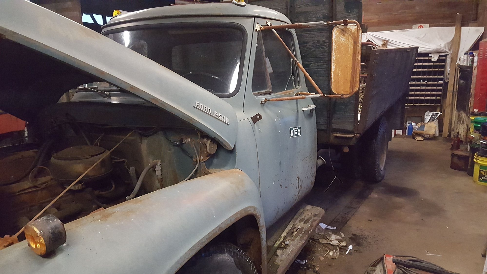

Heres the project vehicle. Runs good, tranny is good, clutch is good.

Wow! Very nice looking truck.

Looks real nice, Weiss. Keep the pictures and your progress coming.
