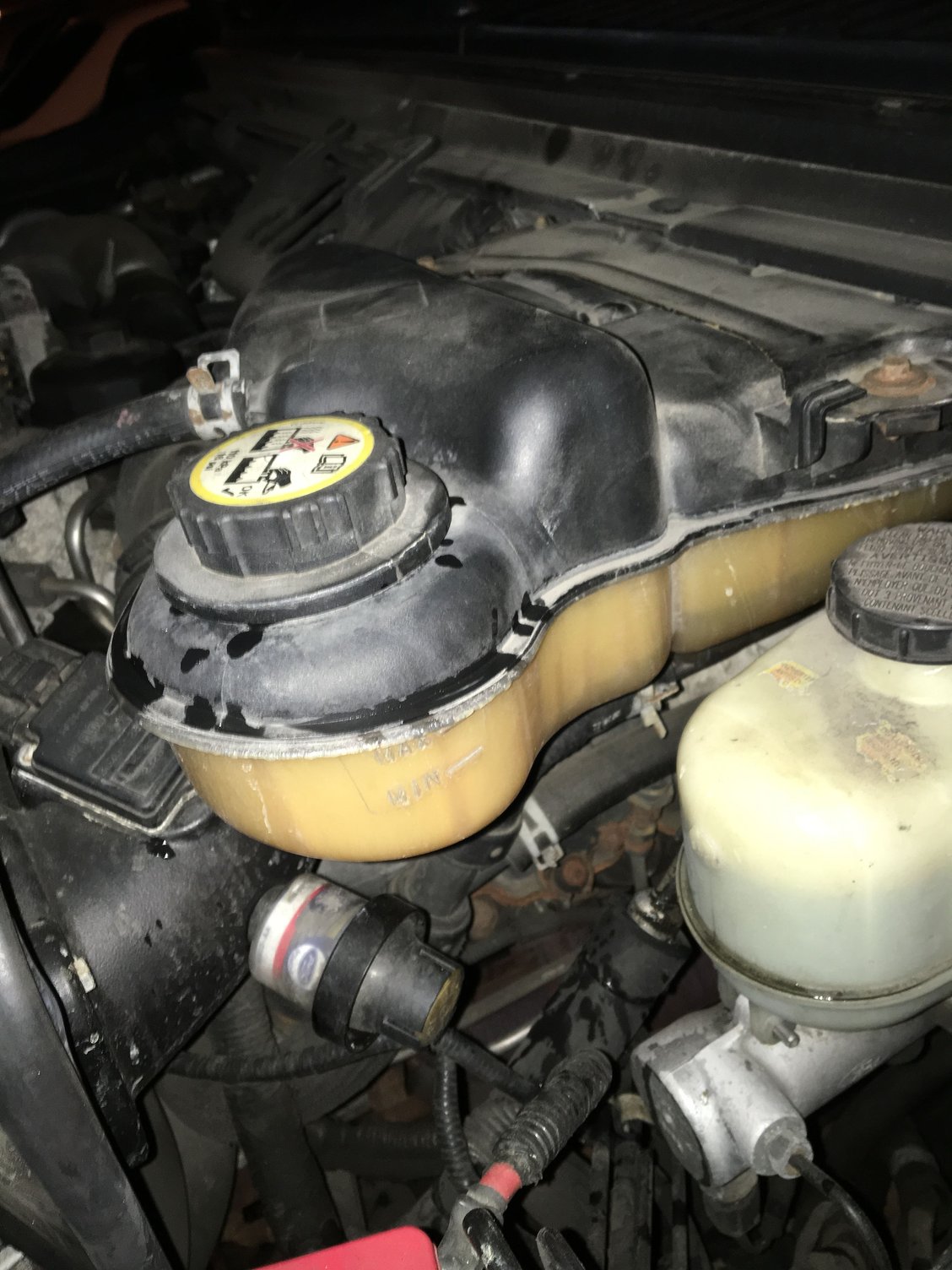

i have a 06 f350 super duty and noticed that when I have the heat on and driving about 40-50 mph I get the smell of coolant inside the cab. My temp gauge stays right in the middle like normal. When I got home tonight I opened the hood and didn't see nothing major. I took a picture to maybe get some help. Anything would help thanks guys!

That white residue all over your degas bottle suggests it's puking coolant & drying. The 6.0 section of the forum has a tech folder that has a wealth of information.
The heater core is the usual suspect if coolant can be smelled in the cab but there's also a few holes for wiring to pass through the firewall right below & behind the degas bottle. If it's puking you will smell it in the cab.

First thing I notice on your "coolant juggy thinga ma bober" is there is no new sticker or reference for the new maximum coolant level, which is the old minimum line.
What level are you keeping your coolant at? How old is that cap?
Ford reduced the coolant level because trucks were puking at a "normal" level because "normal" was too high. The caps can become defective and allow coolant to puke before reaching 16 PSI.
