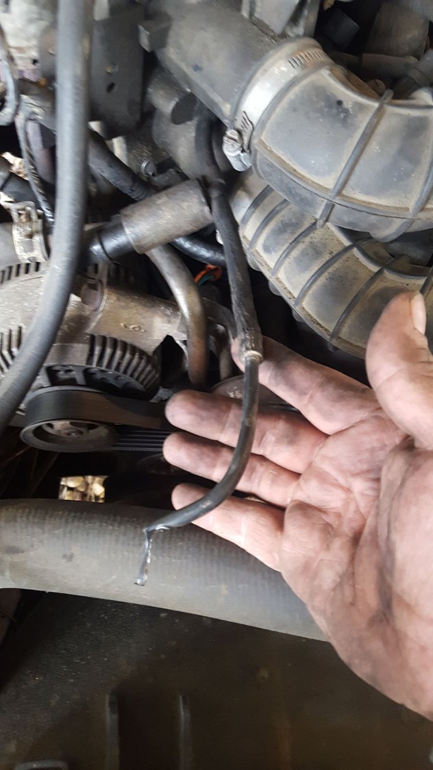

Changed the TPS. I still have a miss of some sort. What is this thing and where does the other end go?
Keep in mind this is a 93 engine in a 95 chassis, if that matters.

Looks like the evaporative canister purge line. Cap it where it goes into the throttle body & it should cut your vacuum leak.
