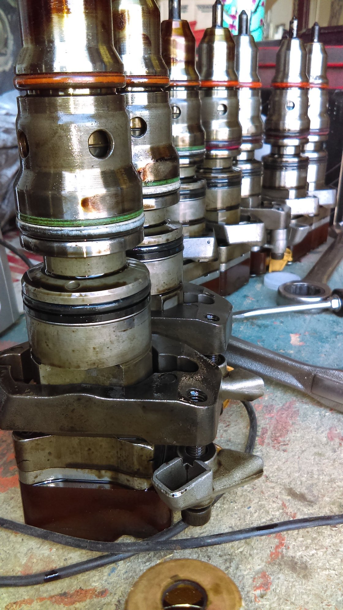

After talking to the owner of the junk yard they did throw obs parts at it since most of of the oem e99 stuff got damaged and burnt when it wrecked, I'm OK with that I'm keeping all the obs stuff for myself. The engine I got from the junk yard has AA injectors and look at what I found
Double O rings on the injectors well at least 4 of them.
