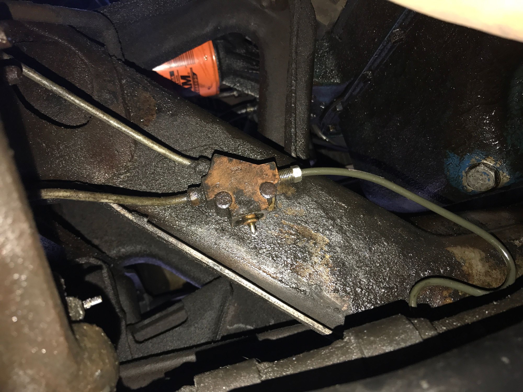

I haven't any problems finding parts till now. Odd that I have brake fluid leaking out of the front tee mounted on the crossmember. Checked the lines, replaced one. There appears to be a plastic "insert" with little metal nipple that's dripping brake fluid. Can't seem to find a replacement

Isn't that the proportioning valve?
Old Mar 2, 2017 | 07:06 AM
ultraranger's Avatar
ultraranger
Joined: Apr 2011
Posts: 6,399
Likes: 40
From: El Dorado, Arkansas
I take it your truck is either an F250 or an F350 from '68-'72 with the optional factory front discs or, this truck has had front discs added to it by a former owner.
The component is a Metering (hold-off) Valve for momentarily delaying the application of pressure to the front brakes, to allow the rear drums to overcome the tension of the retracting springs and start moving the shoes towards the friction surfaces of the drums.
Other than getting a used metering valve from a wrecking yard donor or, finding an NOS valve from a Ford parts vendor, I don't know of any that are readily available.

I forgot to mention, 1972 F250 power disc brakes. So it's a metering valve!
Now I know what to look for. An NOS metering valve or adapt a 73 proportioning valve.

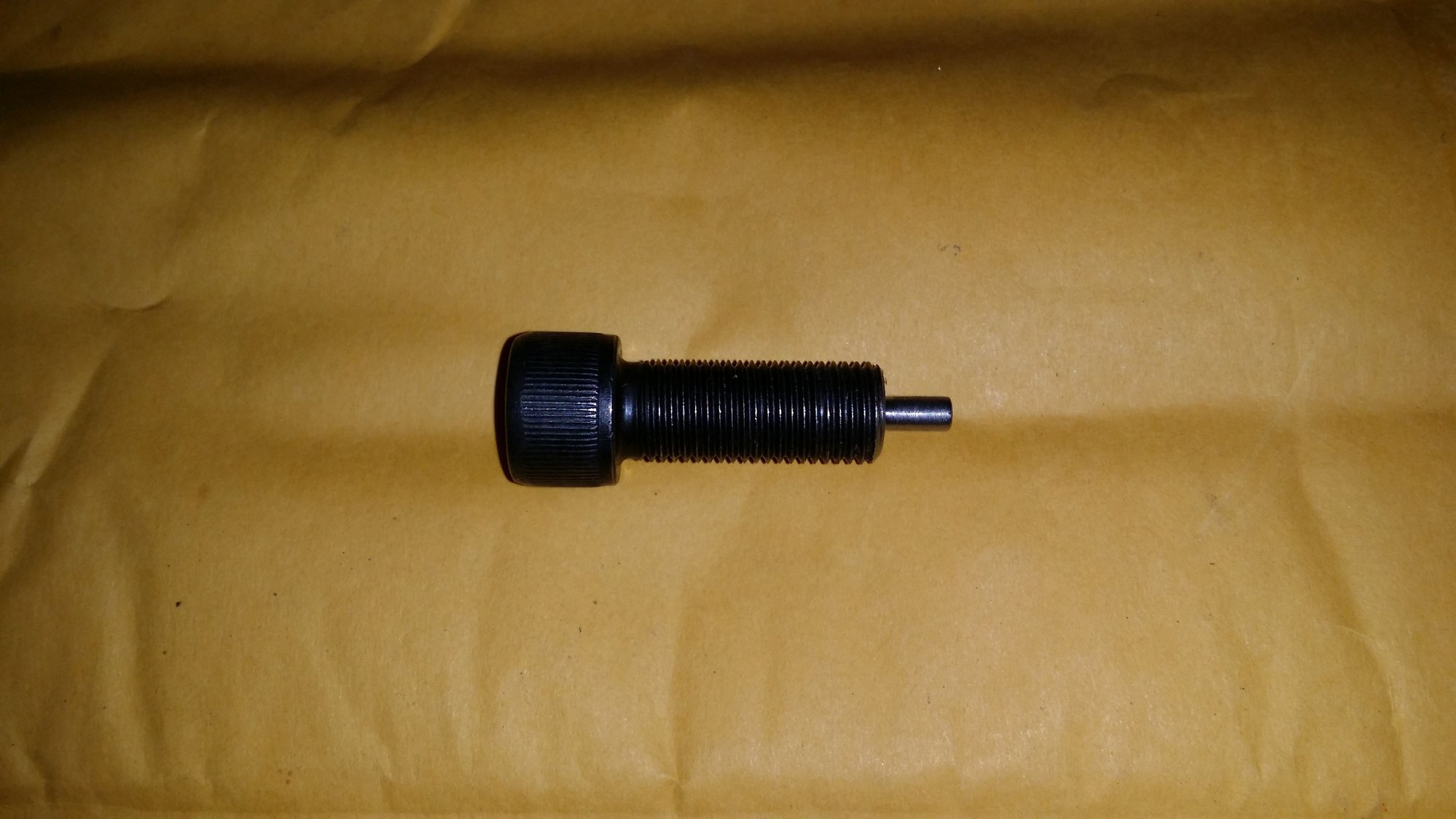

Thanks Steve! I ordered their kit after taking my metering valve apart and confirming that they're the same. I made a little jig out of a couple screws and a fender washer.

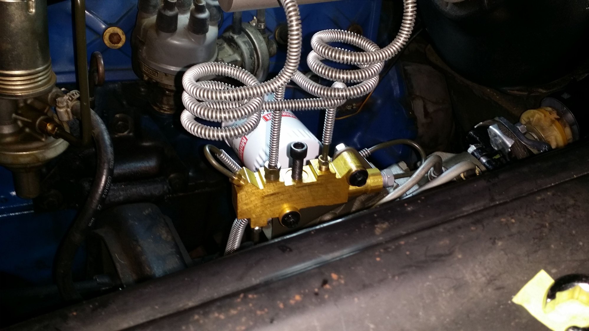

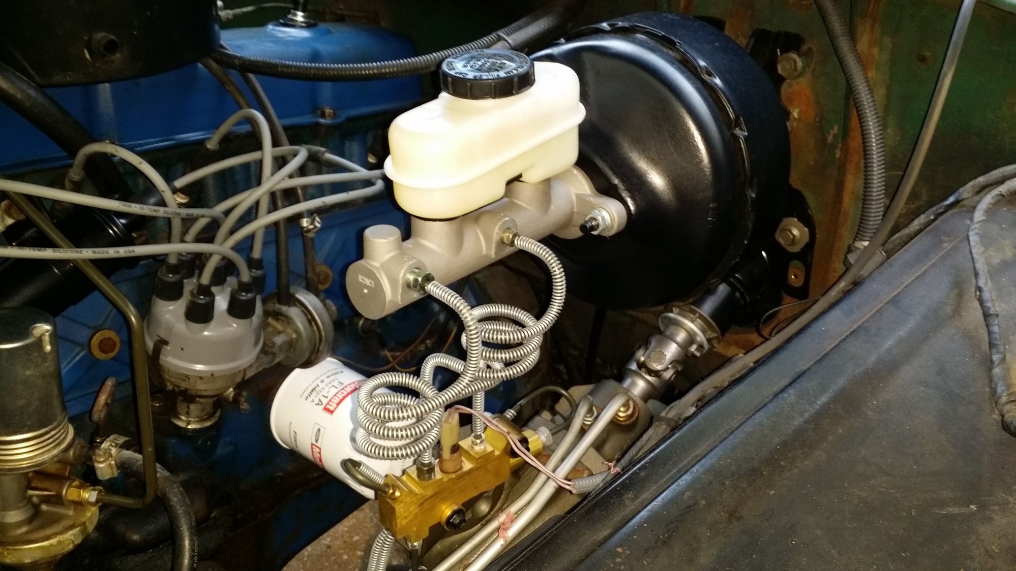

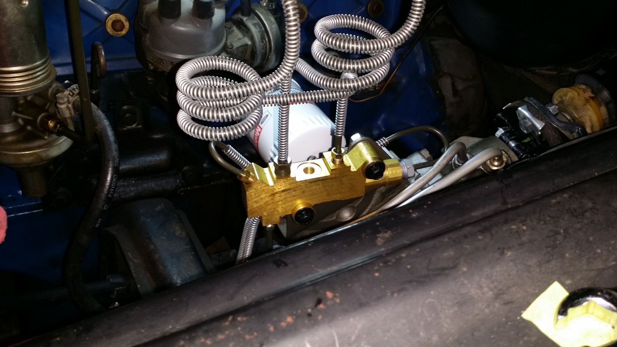

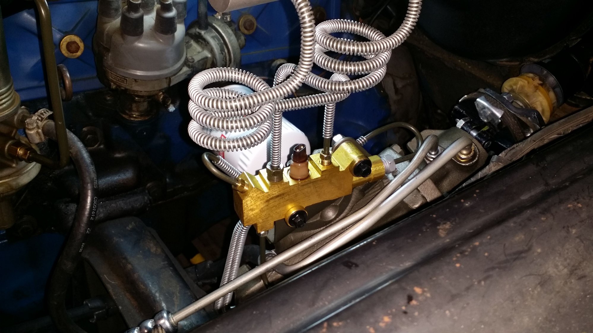

To use it, simply unscrew the pressure differential warning switch from the valve body, screw the lock tool in (finger tight only), bleed the brakes, when through, remove the tool, screw the pressure switch back into the valve body and reconnect the wiring to the switch. --this shown on the brake setup I installed in my truck.
