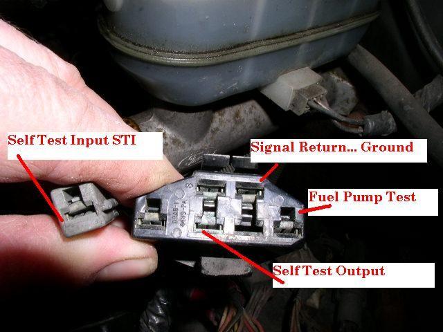

I am encountering a similar high-idle issue, and trying to troubleshoot. No constant ChkEng light, but it did come on and go off during a recent drive. I want to see if any codes stored, but I cannot seem to find the OBD-I test connector, ANYWHERE!
My engine is 5.8. I'm led to believe I am to look for a connector like the attached image shows in someone else's engine compartment (labeled with STI, signal return, etc.). All I can seem to find is the light-gray rectangular connector shown in the other 2 images, and I found that connector behind the interior cover just forward of the passenger door.

A 1994 model year truck is OBD-I therefore the STO and STI test connectors are under the hood near the driver side hood hinge. It may be tucked into a plastic cover that is labeled EEC Test.

Your statement agrees with everything else I have read, but mine is no where to be found. The only additional info I can offer that may affect the placement is that my van is a hi-top conversion van with the auxilliary rear AC/heat, TV, mid-mount additional stereo, etc. Most other work I have done on the van has followed all other "regular" vans as far as placement of wires and components.

You have a van.......a different animal. The data link connectors are located near the driver side headlamp.
