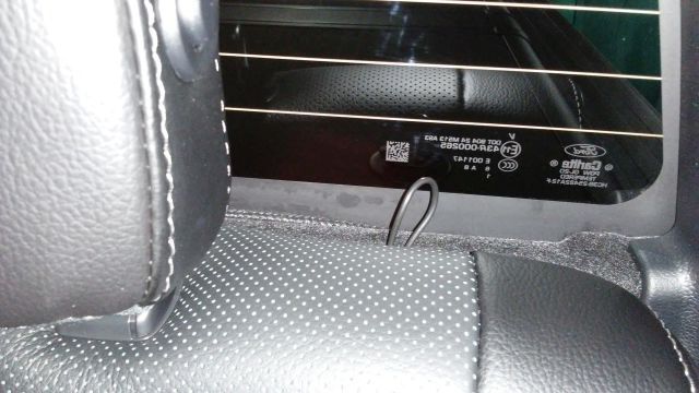

While $30 is more than reasonable for something that is so well made, I sometimes prefer to fabricate things like this myself. I had a 2012 F-150 Crew Cab where both rear seats had one of these latches, so I already had a tried and true method.
First, I folded the seat back down to remove the latch. That is accomplished by folding the bottom up, to gain space between the seat back, and back of the cab. At that point, you can look behind the seat with a flashlight, to view the little round catch pin that needs to be pulled up. I used an open-end wrench to pull the pin up.
With two small welds, I attached a washer to the end of the pin, and ground the welds somewhat smooth. It doesn't have to be pretty...
Latch with washer attached.
The loop was made with about 16 gauge stranded, insulated wire. I slipped a piece of heat shrink on before soldering the two ends together. This loop was attached around the washer with small zip-ties, and another zip-tie at the top for a finger loop.
The paper is only there so the wire is more visible.
Latching the seat back in the upright position again is made a little smoother, by lifting the seat portion slightly, as you "gently" slam the back onto the latch. With the seat back in the upright position again, the finger loop stays in place, and it all works very slick, for free.
