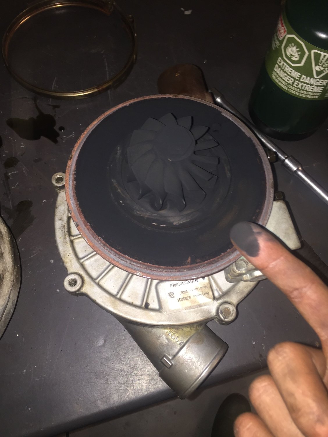

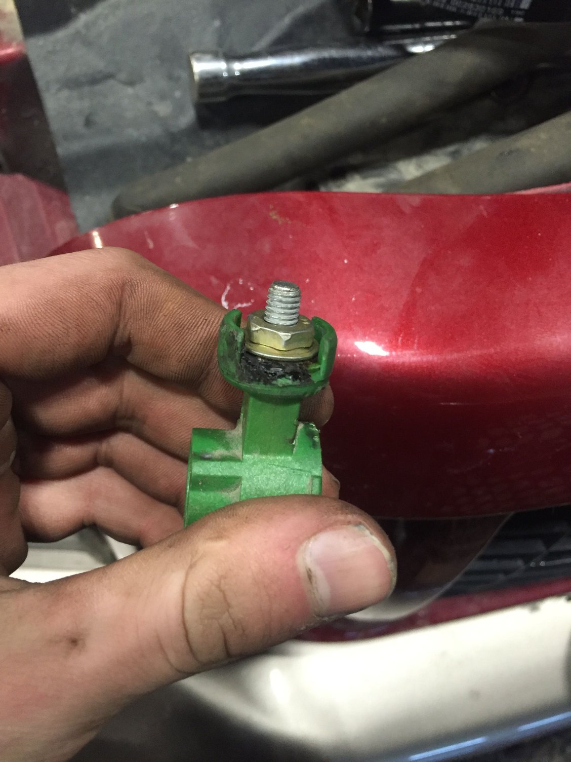

I think the problem was two fold, please correct me if you think I am going down the wrong path. Turns out the alternator was putting out like 18 volts and fires were starting (literally melted a lead connector at the battery terminal and looks like the insulation/plastic at the alternator was about to catch fire), I don't know if this could cause the injectors to go nutty but I've switched out the alternator with a new one, also going to a 135 amp over the stock 110 in the process, and it seems to be idling fine now.
In terms of the lack of power and then death, I think it is the turbo sticking. Has been barking at me a bit lately, and I think its finally just seized. Will tear into it to see if I can clean up the unison ring tomorrow.

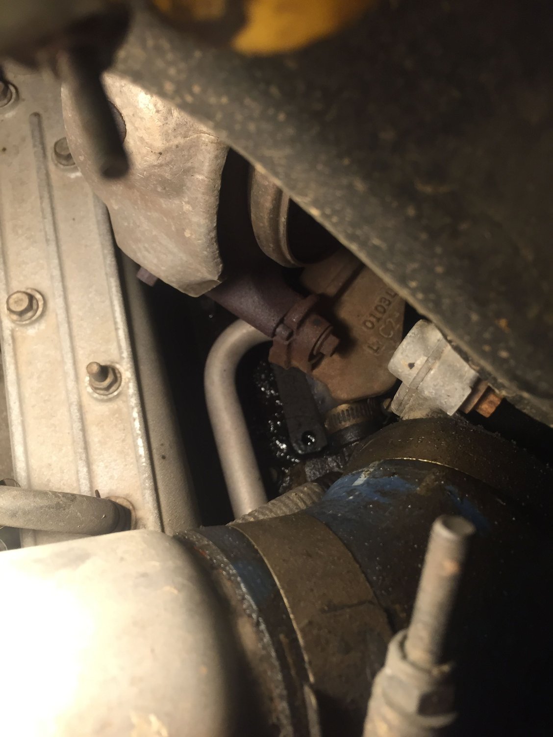

In terms of the coolant leak, it looks like all that talk about those $60 EGR delete kits' coolant hose sections being junk are true. That seems to be the leak point as the engine valley around it is soaked.. After some research, there was no change in the coolant colour/texture (which I'm told can happen with a headgasket) and there was no overflow from the degas bottle which I've read happens when the system is over-pressurized. So I think my heads are fine - thankfully.

Turns out the alternator was putting out like 18 volts and fires were starting (literally melted a lead connector at the battery terminal and looks like the insulation/plastic at the alternator was about to catch fire), I don't know if this could cause the injectors to go nutty[/IMG]
The 6.0 FICM is sensitive to voltage outside of spec and will cause problems you wouldn't think it could cause.

Tore into it a bit tonight after work, got the turbo out and cracked it open. I can see why it seized - wow is it ever sooty.
Going to clean it tomorrow and also fix the coolant leak. With the amount of soot I'm feeling like a rogue injector might be the source of my rough idle and turbo issues, however have not been blowing any smoke at all.
