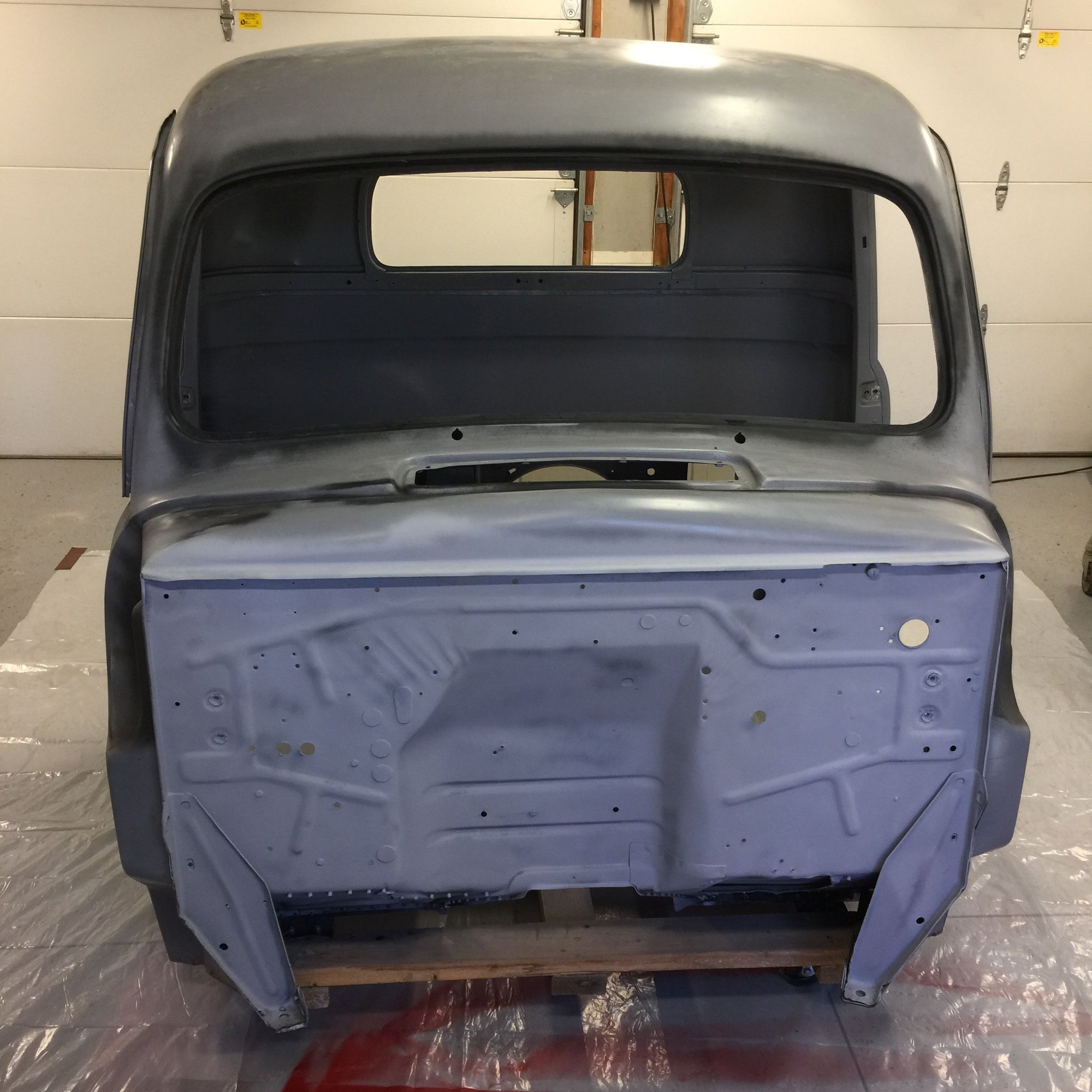

Hi mOROTHBREATH,
do yourself a favour and do the paintjob the right way, meaning no brush but spray! I'm trough with that job and I can tell You that it is the best way.
You'll have to spend up to 2 hours to prepare everything (covering all the parts you don't want to be sprayed). Afterwards grind all the surfaces, clean them with silicon cleaner. Than You can use a base coat. Then a light filler if needed and another grinding and cleaning afterwards. Then another base coat and at last the final color and maybe a clear coat. Including the times
for drying etc., You can estimate about 3 or 4 days where You can't use the car. But it's worth the effort! That's how it looked, when I had prepared the cabs interior:

OK, so it sounds like I need a good reconsidering. I don't expect show quality work, but maybe hand painting would be less practical than I first thought...and look bad.
rico's picture actually gave me the "ah-ha moment": I don't have to remove the entire interior and paint every surface, maybe just dash and doors and mask the rest off!!! I didn't think of that and was wary of removing every-single-last-piece down to the wiring--and still being fast enough to get it back on the road ASAP.

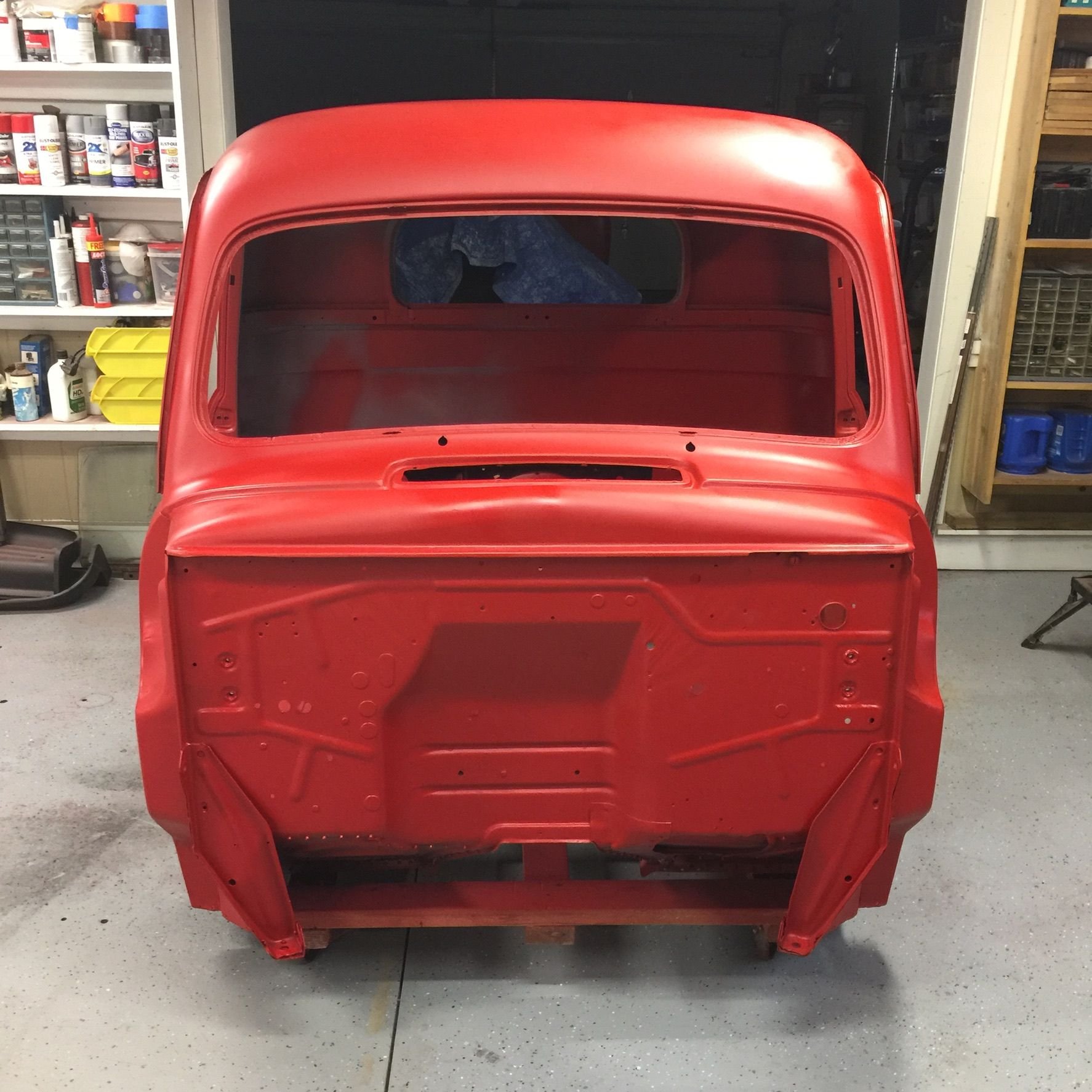

The results are worth it. I finally got my cab #2 painted today. Now I can install it on the chassis tomorrow. It has been a while.
Second coat on today.
Hot Rod Flatz color Hot Rod Red
