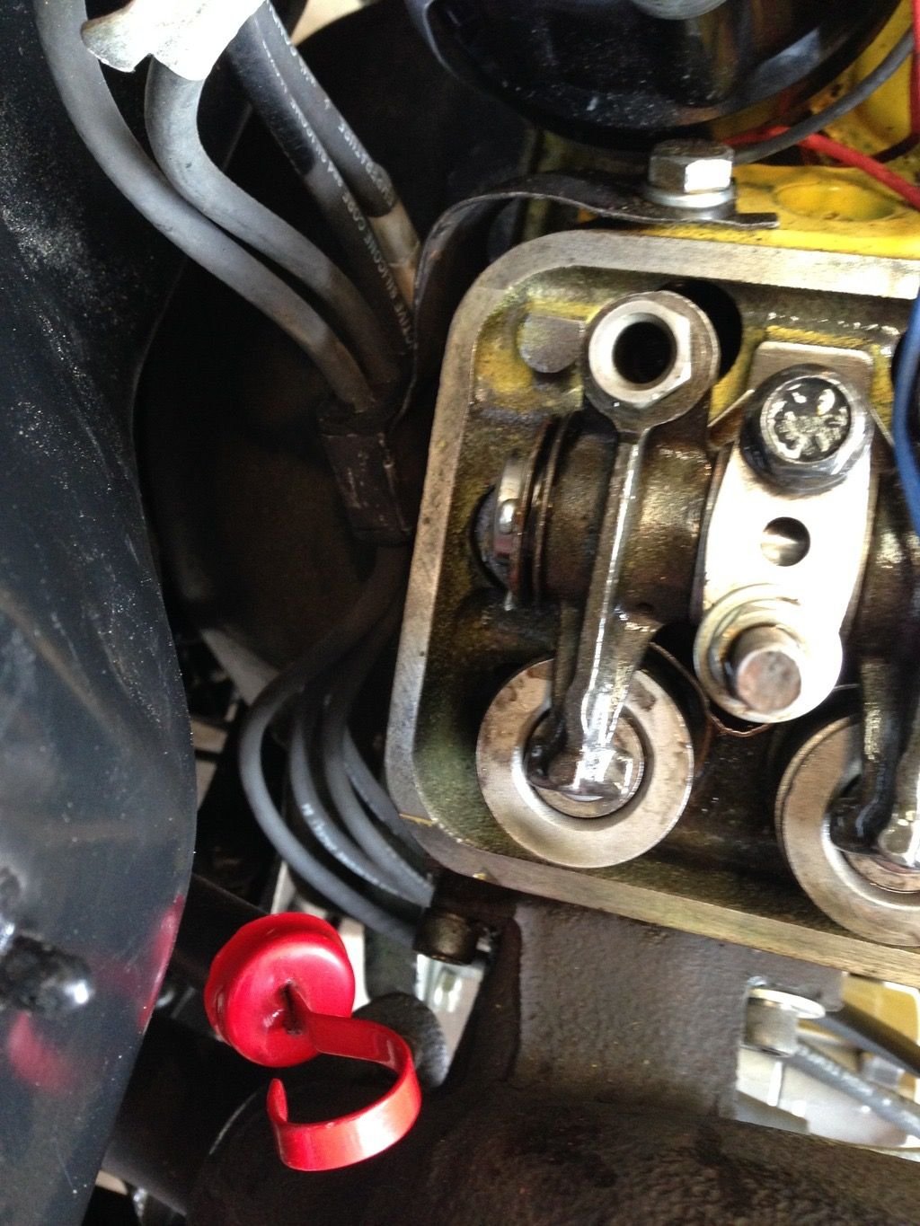

So, tonight I worked on something I've been wanting to do for years. That is to put my spark plug wires around the back of the engine as they were originally. I got three of the four grommets and brackets in the right place but I don't know where the fourth one goes.
I looked in the shop manual and a 54 dealer catalog to see how to run them. But no help in the fourth one. Does anyone know where it goes? Here are the pics.

And here is what I did tonight.
And here is the bracket that I don't know where it gets attached to.
I know where the grommet goes thanks to my 55 that still has the grommet but is missing the bracket.
Hmmm, could it attach to post where the coil is attached to?????
Or could it get attached to the other hole in the back of the intake manifold????? Any ideas?

Here's how I mounted mine. May not be right but it works.

BJ's wire loom looks right, according to these pictures:

Effie, those pictures show what I need to know. It bolts onto the head.
Thanks.

My truck didn't but the 239 I bought off of Craigslist list did. Mounted to the head is correct.

That is awesome Dave! Thanks. That shows exactly what I need to know.
