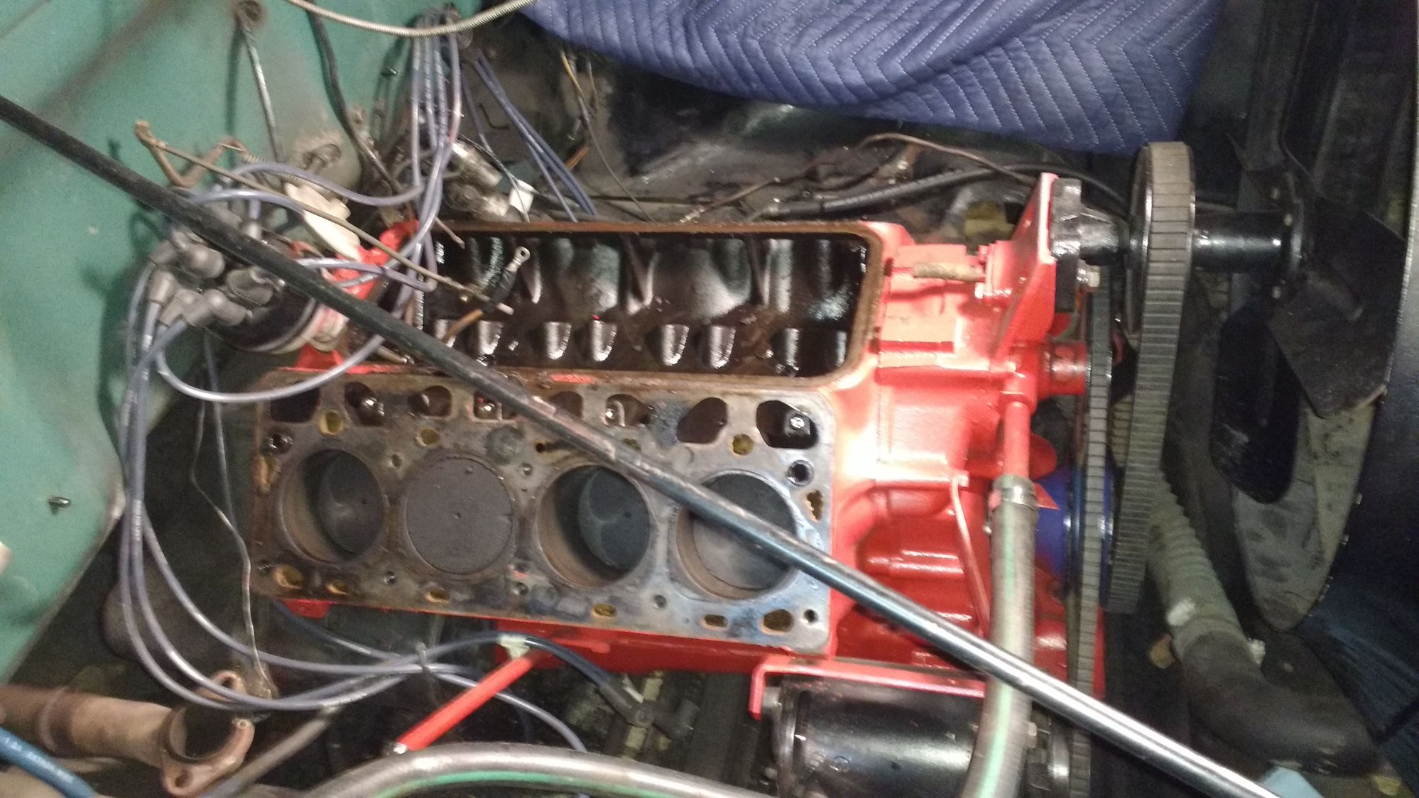

Here are pics of where I am at tonight.

One area of concern. Some of the water passages in the head gaskets are clogged while some are partially clogged. Is this to be expected? I don't remember when I last put in new antifreeze. Should I flush the system before I add the new coolant?
Pics of one gasket on the block and the other off the head to show you the gunk.

Abe, a flush is never a bad idea - especially after a teardown. But with that being said, I think what you're seeing is perfectly normal. The coolant holes in the head gaskets are normally much smaller than the holes in the deck of the block and the heads and sometimes they may not have any holes in certain locations at all. The engine designers use these size of these orifices to tune coolant flow for even cylinder head temps. If you compare the old gaskets to the new ones you'll see what I'm talking about.

on that pictures I can't see a damage on the surface of the pistons. That's good! Meaning that the valve that got stuck, didn't touch the piston! otherwise that could have caused severe damage on the pistons and even
the crankshaft! But nonetheless You'll have to pull that valve and check, if
it is bent!

Thanks, Rico. I am putting different heads on.
