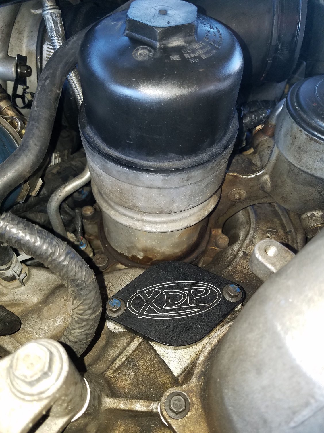

Clean that XDP label for better performance, we all know chrome is faster than black but hey it was probably there when you bought the truck. Yes, EGR deleted.

Can some one provide commentary on that Oil Filter Cap? It looks oddly tall to me.
If the Oil Filter Cap is not OEM then an EOM Oil Filter will not install correctly - check it out.
I can't say. I have not replaced the cap, just the o-rings when i changed the filter. I did not encounter any issues installing the motorcraft 2016. Here are different pics.
I assume from the spanish that it is in fact non-oem
And Steel wool cleans it right up.
i was thinking it looked oddly tall too... even for the later style 6.0's..
as to the antifreeze in the CAC pipes there shouldnt be any antifreeze in there.. Oil does make it into there via the CCV tube and bad turbo seals.. but it shouldnt have coolant in there at all.. the intake manifold could have it if the EGR cooler was bad but with the CAC pipes being before the manifold it wouldnt be contracting there.. the intercooler is Air-air not Air-water.. if it was water cooled then id say it could happen if the intercooler sprung a leak.. but the intercooler is air-air on these trucks.. now if theres coolant in the oil in the pan for whatever reason then it could be sucking it in via the CCV pipe.. at which point if hes getting coolant in the oil pan then hed have a much bigger issue than the truck running bad because of poor fuel flow..
