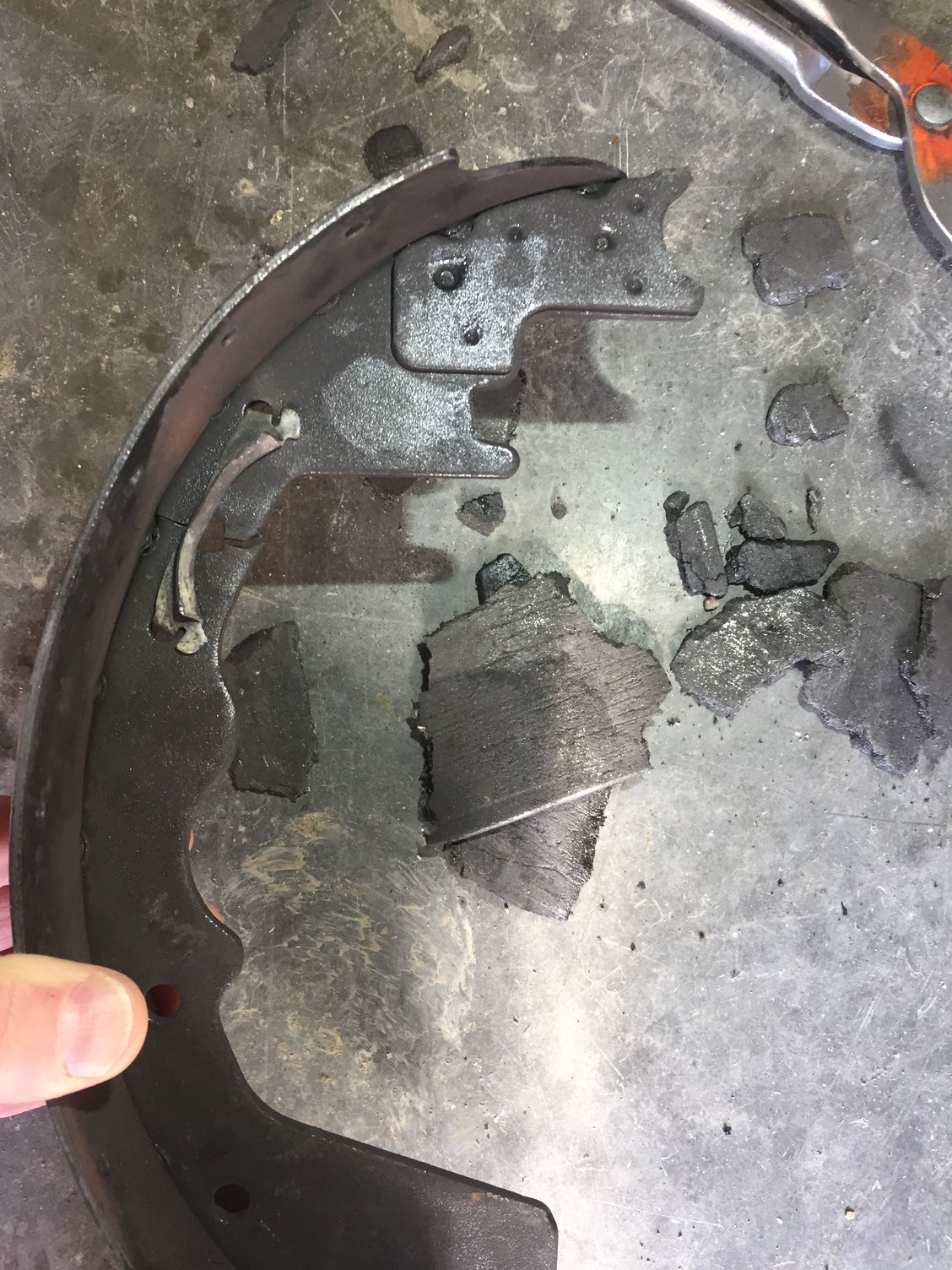

Update/fix
at a shop now. Posting for general knowledge.
Right rear drum is bad. For whatever reason inner shoe cracked. Causing things to not seat right. Which caused my pads to completely crumble. The locking up I felt most likely the pads locking up and being destroyed. Cracked and crumbled

Were those bonded (glued) or riveted linings?
