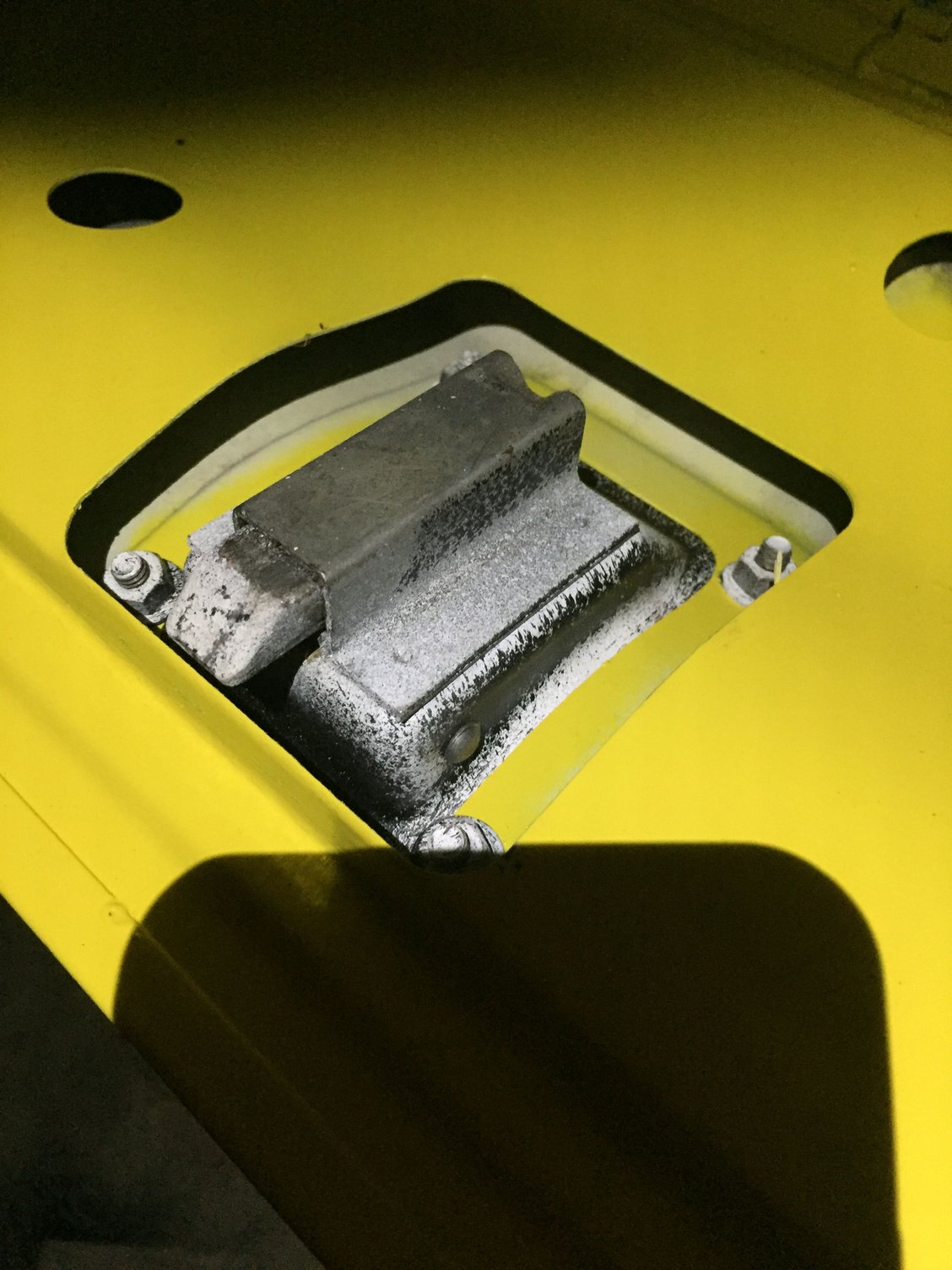

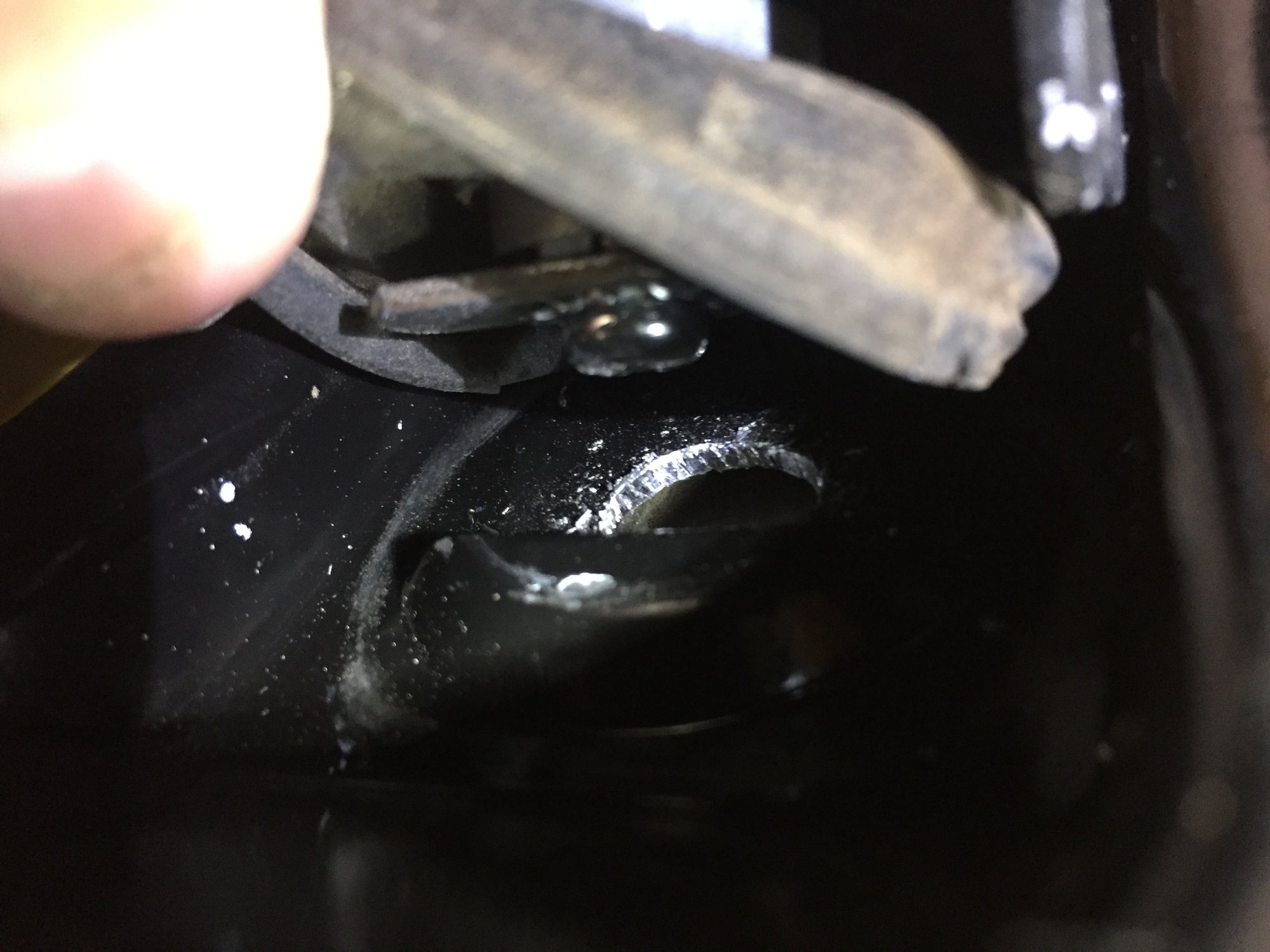

I completely disassembled mine, sandblasted and painted it black. I'll get pix later. I replaced my lock with one from menards, the only issue I had was that the new one has a larger screw holding it together while factory was more flush. I solved that issue by drilling a hole where the screw made contact. Pretty easy fix and now mine is good as new.

Originally Posted by brian1080
I completely disassembled mine, sandblasted and painted it black. I'll get pix later. I replaced my lock with one from menards, the only issue I had was that the new one has a nut holding it together while factory was more flush. I solved that issue by drilling a hole where the nut made contact. Pretty easy fix and now mine is good as new.
I'd like to see a pic of that latch. IIRC the new cylinder had a various pieces of flat that turned to lock the door(held on by nut). The newer replacement latch had to be modified cause it would not hold the door shut completely. Seems like it was too long and I was using the shortest key cylinder I could find.
It wasn't a prob holding the cylinder to the latch...it was the key cylinder being the right length with the tab in place.

I reused the tab from the original tumbler. I'll be home in a couple hours and wiill show you.

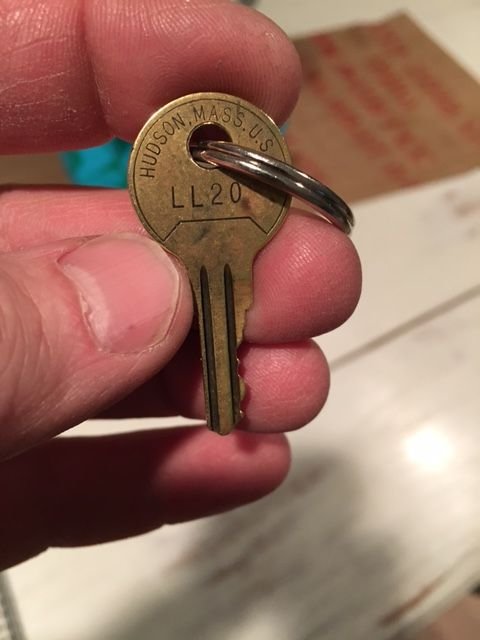

Here's what I believe is one of the original keys to my bedside toolbox. Functions like new.
Manufacturer and code are on it, locksmith should be able to tell what kind of key it is, hope it helps.

Old Feb 14, 2017 | 07:16 PM
brian1080's Avatar
brian1080
Joined: Feb 2010
Posts: 1,742
From: Near St. Joseph,MO
Bottom pic is the pieces left over. I think I reused the actual threaded part, just swapped the tumbler
