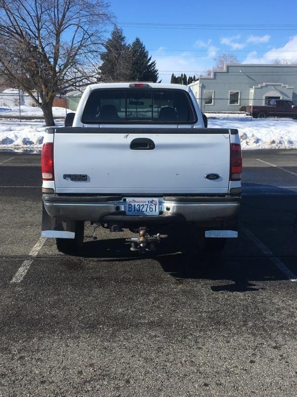

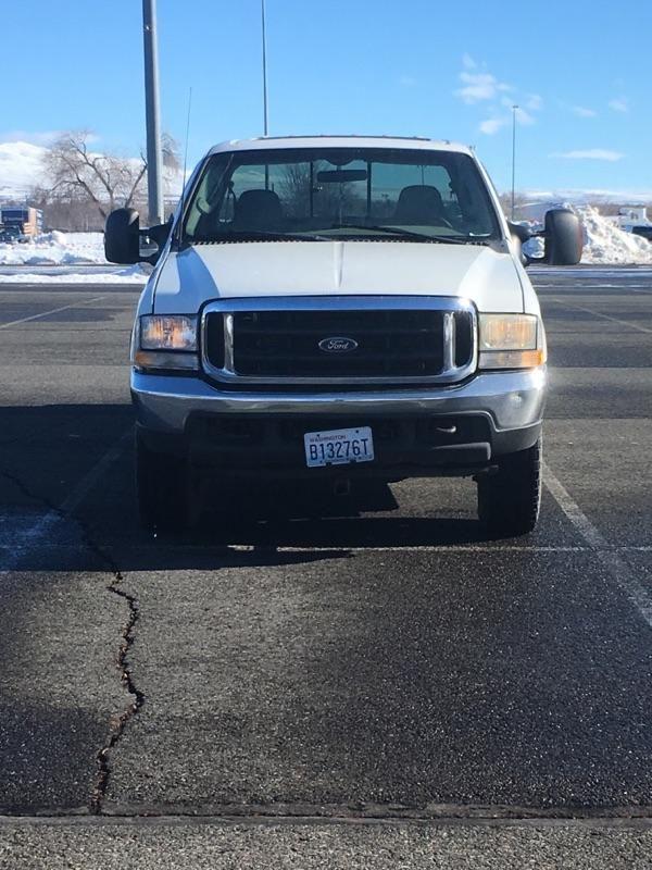

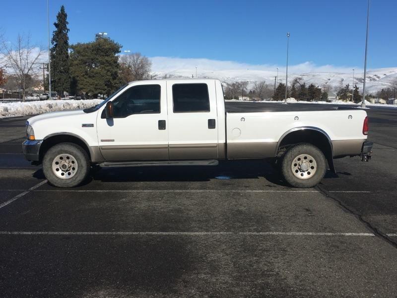

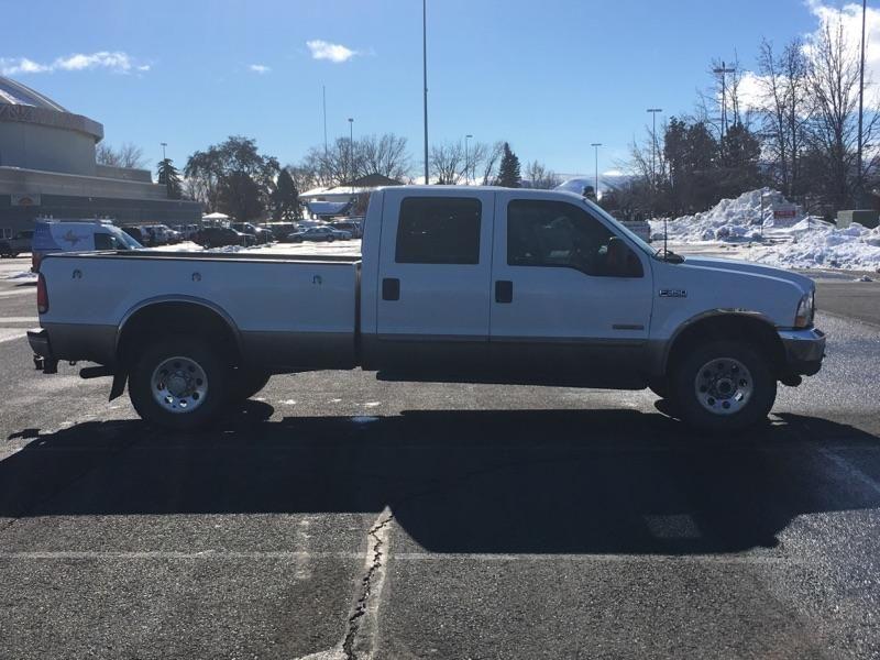

From: Yakistan, WA
Some Pics of the truck
It is a Lariat, but with manual A/C and Heat.
It has a sun roof. Just over 173K. 4X4.
It is just like my 2004 6oh I use to have as far as color.
