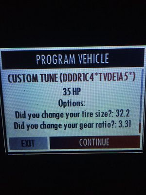

cangim's Avatar
cangim
Joined: Nov 2003
Posts: 3,595
From: Utah County, UT
Originally Posted by EO2SeaBee
With my tuner, I just changed the rear gear ratio in the system from 3.55 to 3.31 to get me close. The tallest tire option I could select was 34" on my tuner, which was what was already there.
Did this affect any of the abs/stability/traction control systems?
Going with 3.31 and a tire size of 32.2 should net/mimic a 34.5 with 3.55 similar 33.9 w/3.31 is close to 37 with 3.55
So I am curious if this logic will create problems with individual wheel speed sensors as they are tone ring type I believe.

Old Feb 8, 2017 | 09:37 PM
cangim's Avatar
cangim
Joined: Nov 2003
Posts: 3,595
Well. We will see if I have a normal drive tomorrow or make a system mad
I am expecting it to get mad and have to reprogram back to 34 and 3.55, unless each wheel speed sensor is relative one another and doesn't look at vss on diff

My new tires are 295/65/20's. My factory tires were the 34.5" as you had. Since my tuner would allow reprogramming for factory available sizes only, I couldn't get it any larger than it already was. I lied to my computer and told it I had changed the rear diff to 3.31. I have had no issues with this new configuration, and the speedo appears to be more accurate.
