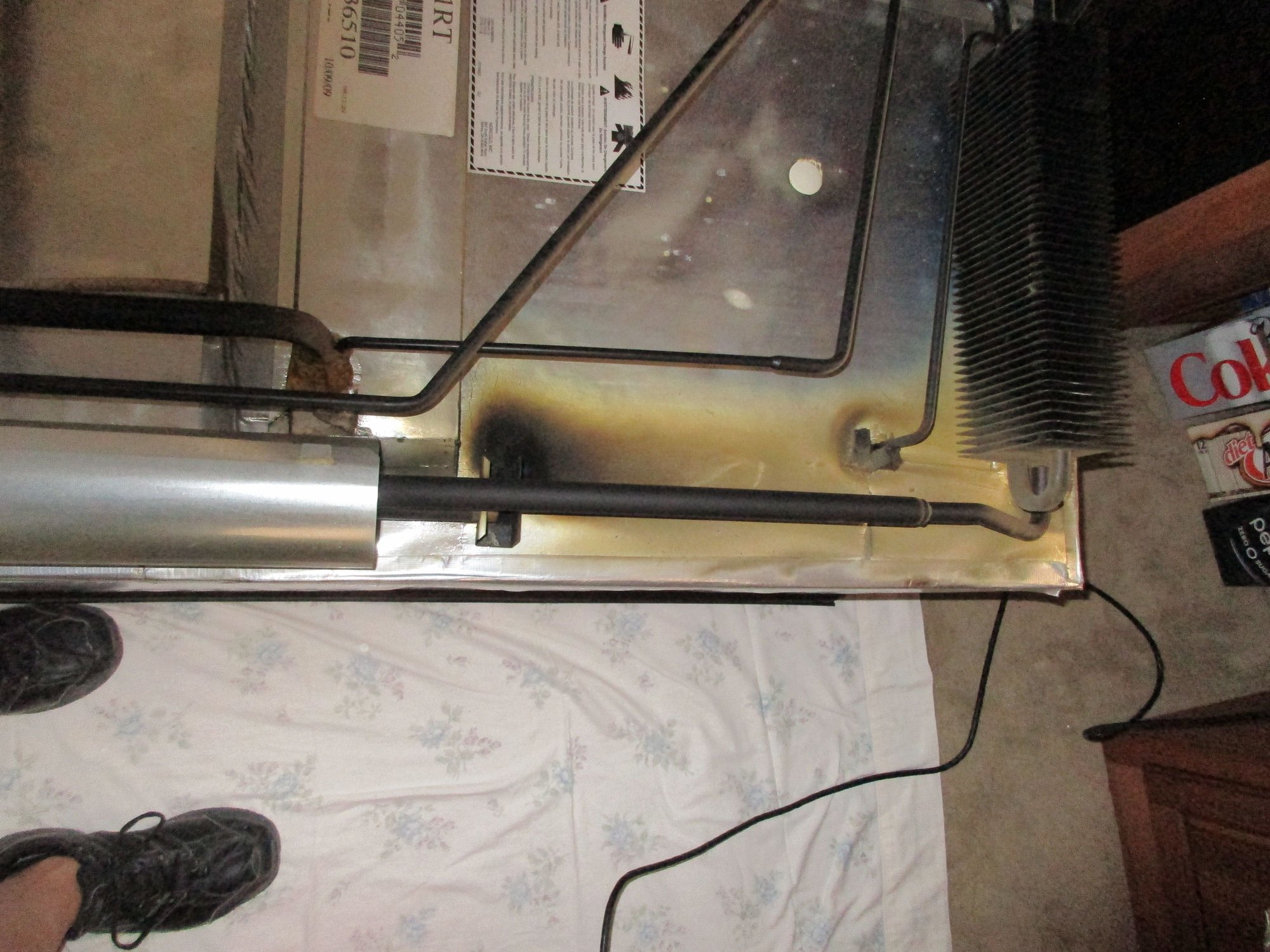

I've been having trouble with the fridge on propane, carbon build up on the electrode spark sensor and horizontal burner tube. Took them out cleaned them up and replaced the propane regulator on the rig. Still was having an issue with cooling a little so I decide to replace with an Amish cooling unit (built thicker and better than OEM.This is what I found when I pulled the fridge out,
that is the baffle tube that the propane exhaust goes through, there is a long rod in it with a 6' flat coil that was completely blocked with carbon/ soot. . Something to think about if you use your fridge on propane. I know after seeing this that the fridge will be pulled out once a years and baffle tube checked.

Steve - or scraprat, can you tell us what we are looking at here in this photo? Or looking for if we try to "clean" our own refer? Thanks.

In that picture the fridge is laying face down o the ground. There is a short exhaust tube (baffle) behind the cooling line going to the fins above. In that tube there is a rod connected to a flat spiral piece,
this is what should get pulled out and cleaned. On my rig you have to pull the fridge from the cubby to do this.
Here is a pic of the Amish cooling unit I replaced.
The yellow area is the top portion that goes behind the freezer/ fridge area that cools/ freezes. I don't have one after I put in the fridge before installing it in the cubby.

In the picture the refrigerator is out and has been taken apart so the entire cooling coil has been removed. The cooling coil is what you are looking at in the picture.
The long can looking burner tube is what the exhaust from the gas flame at the bottom rises through finding it way out at the top. The blackened spot is where the heat exits the burner tube. Inside hangs a baffle, which very seldom gets carboned up and causes a problem. Although the problem is pretty dramatic here, given what I think is a rare situation, owners might be better served to make sure their burners are not loading up with rust or dirt.
