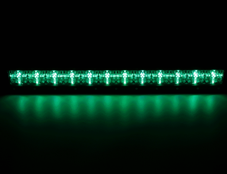

Hi, check out our new arrival, led light bar with RGB CROSS-STYLE DRL, it'd definitely look cool in your F250.
Here are some of the colors
And here is our DRL led light bar with cross style
Please PM me if you have any question -Alice
