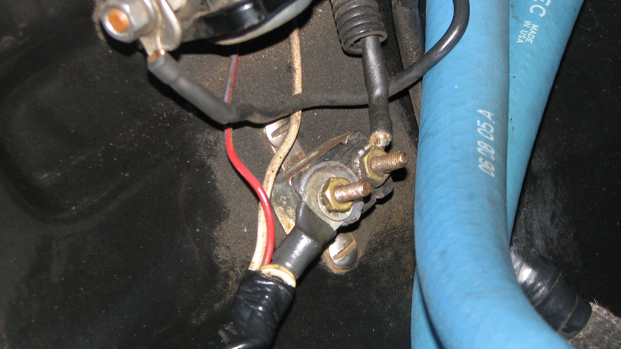

What is this part?
1966 F-100 6 cylinder. What is this part to the left of the starter solenoid and where can I buy a replacement?

Old Feb 2, 2017 | 08:03 PM

Grounding block

Awesome thanks. Do you have a part # and know where to buy? Currently lose and hitting metal and sparking.

Wiring diagram shows it as a junction block. I thought it was grounded. Don't know where to get one but should be able to fix.

That's correct. It should be heavily insulated from ground. If those wires ground out you can fry some of the wiring.

Thanks. Hoping someone can include a part # and a hyperlink of where to buy this part as mine is not repairable.

Here's a modern replacement... https://www.delcity.net/store/Juncti...FYM8gQodmkQGjg

NPD sells a repro for a Shelby part number 14448-1A, $35

Thanks but looking for a reproduction or NOS as I dont want to drill more holes

Ford superceded the part at least twice by 1973 - There are NOS junction blocks available with the newer part number
D3TZ-14448-A | RearCounter.com | 75 found at 5 sellers
I don't know of anyone reproducing the orignal style for our trucks, but this later one is the service replacement part.

Here's a link showing what the later part number looks like. As you can see it will be visually different at a minimum.
Motorcraft Junction Block D3TZ 14448 A Ford Terminla | eBay

Another alternative for the alternator gauge would be a fuse block as opposed to the junction block. Installed a 30 amp fuse block in the 65.

If you don't like the yellow replacement on here is a black one that ford used for the ammeter
1967 1970 Ford Shelby GT350 GT500 Ammeter Junction Block New Correct | eBay
